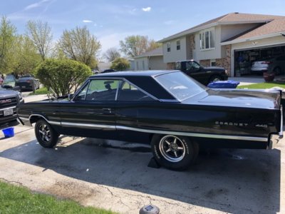

275/60/15 on a 15x7 4.5” bs
Not fun to get off lol

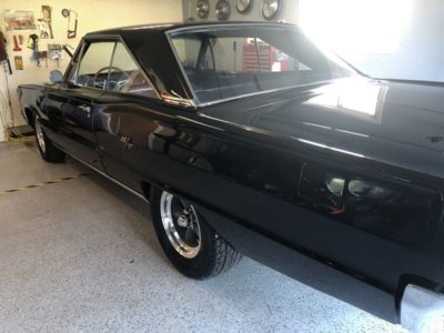

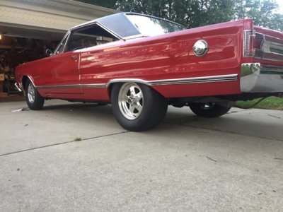

My 67 RT has 275/60/15 tires. Does not rub on the passenger side, but does rub on the drivers side wheel well
275/60/15 no mods.. caltracs set up with stock ride height.. I have a good friend with a 67 coronet running same size mine took 5” backspace no rubbing issues at all. Car runs in the mid 11’s and is driven 2000 miles a year on the street
