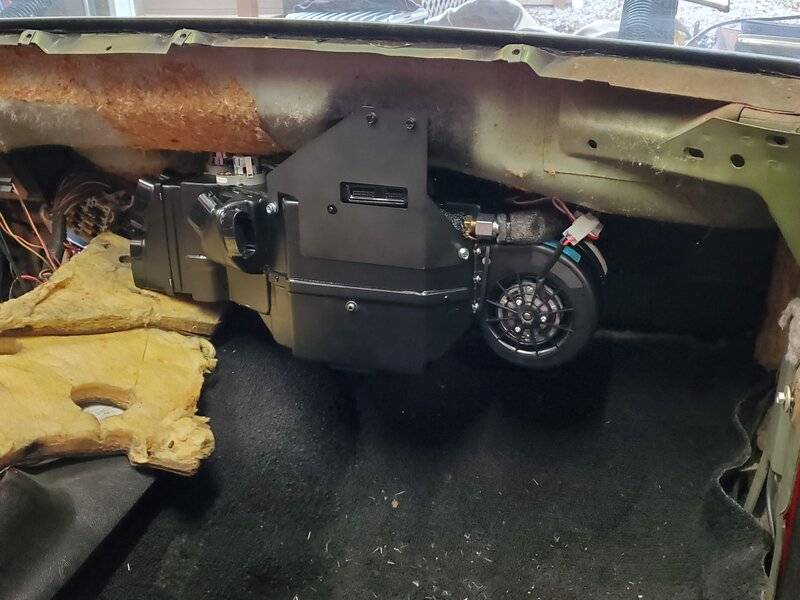

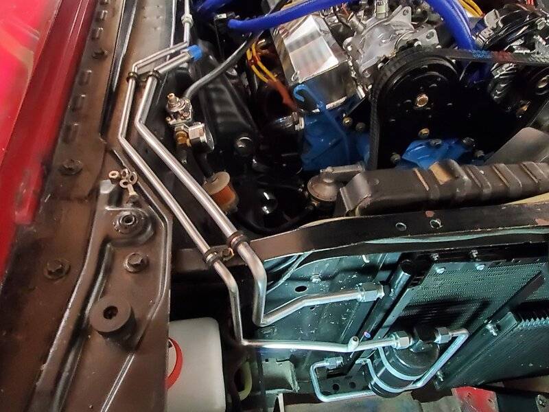

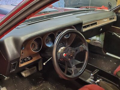

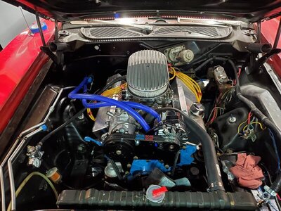

I added vintage ac to a 71 charger that was a non ac car.I had the factory ac vents that I found years ago.
Great job!
Is that a kit that you spec’d out
Or is it a direct fit system?
