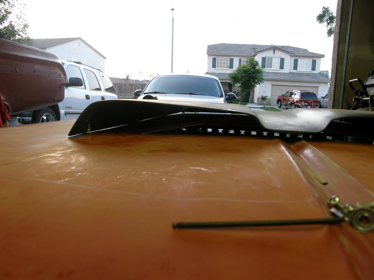

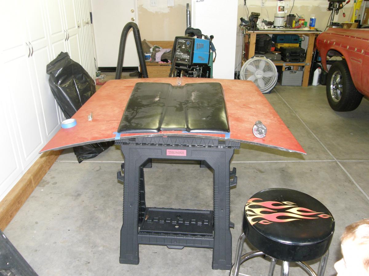

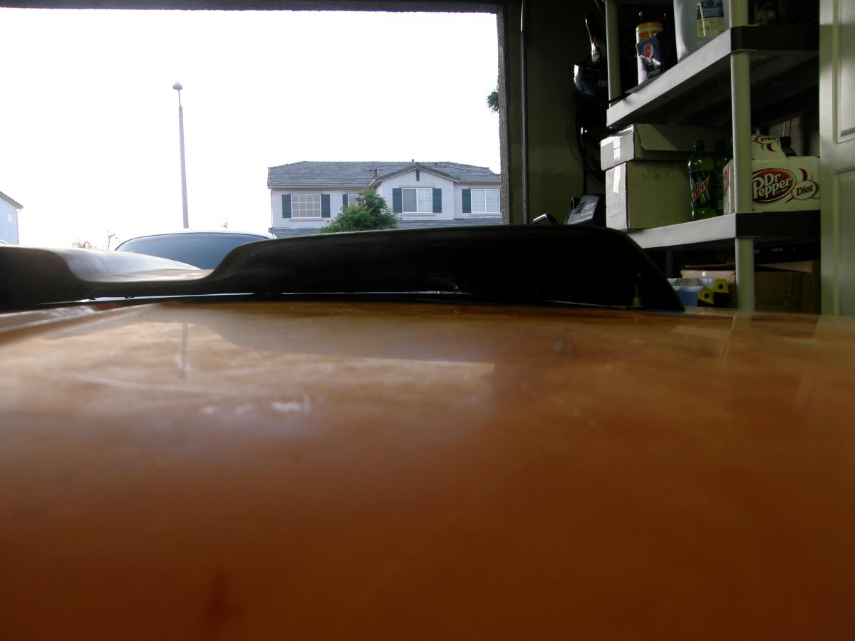

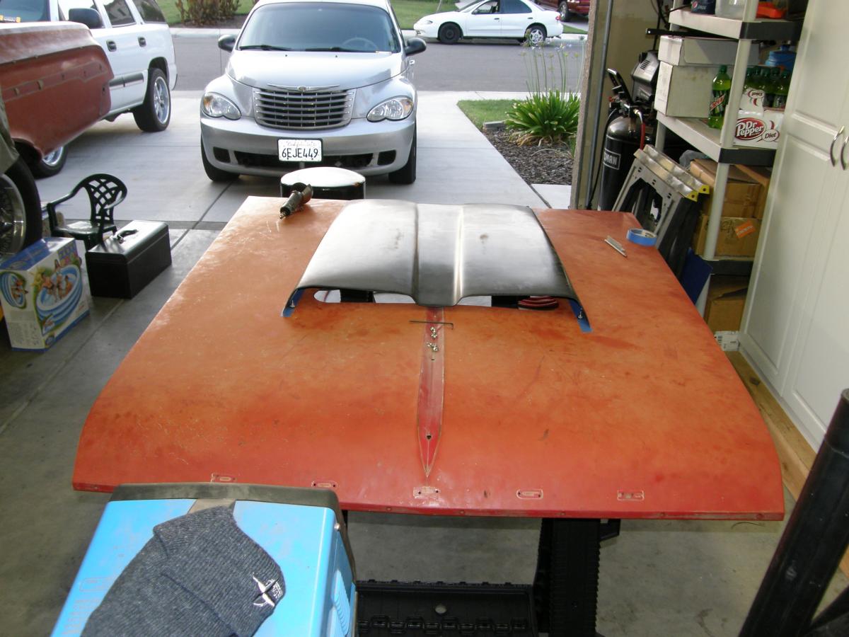

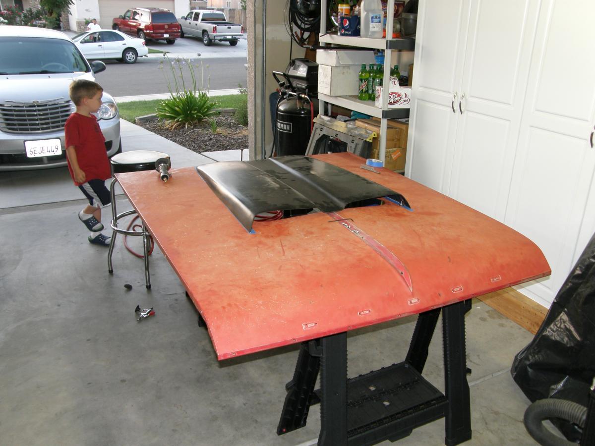

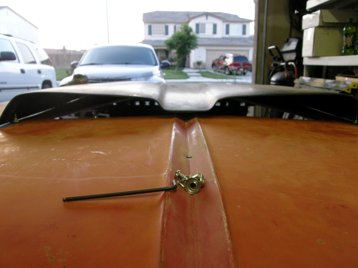

Hoodscoop is damn near done, 4 more holes and she'll be set. More pics will follow in a couple of days.

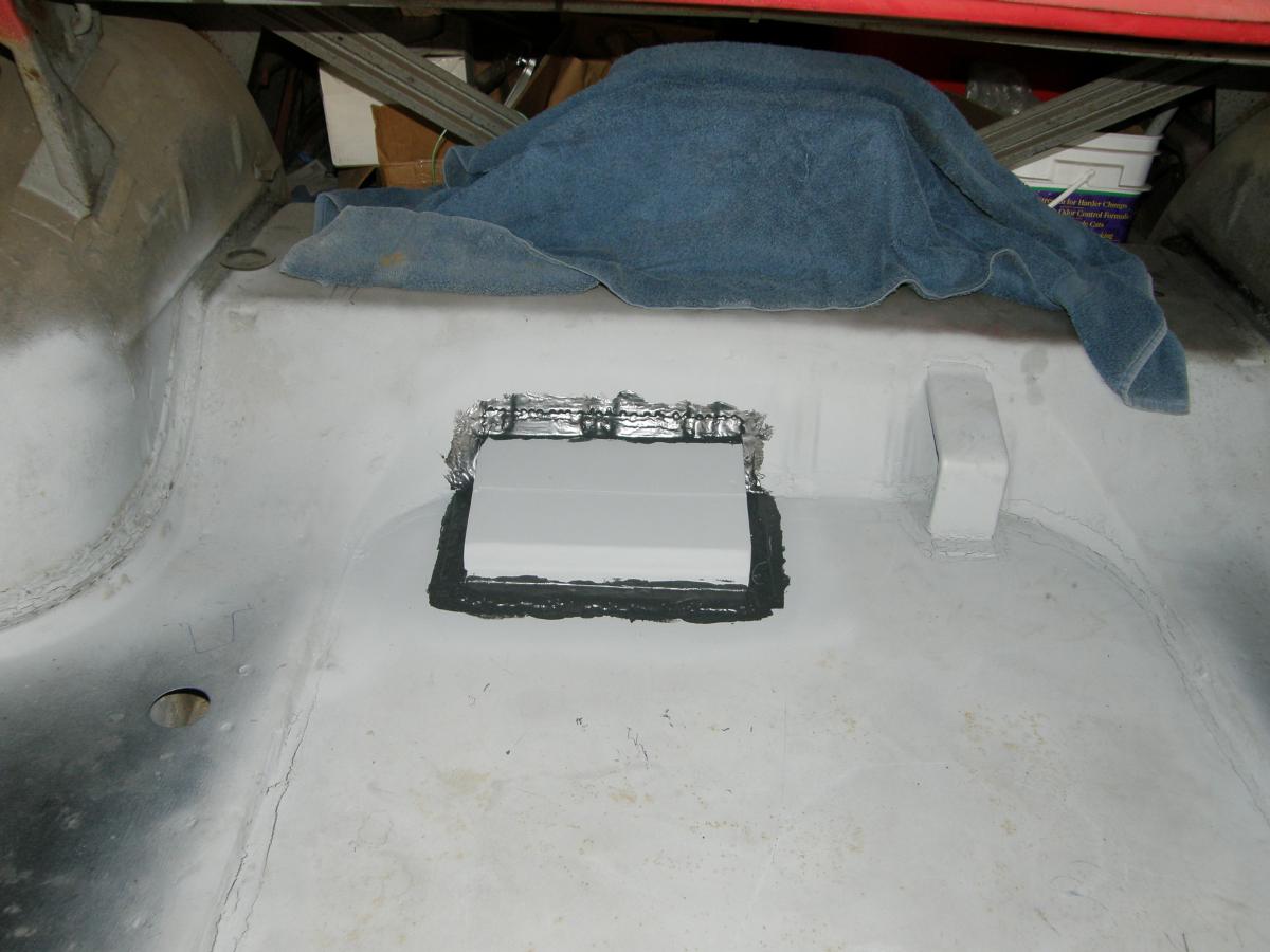

Pics of the bump in the trunk for the fuel pump, and also the hood scoop.

Hey 5.7, I have been following your posts. I really love the work you have done, it is a sweet ride. What is the stuff you used around the hump you made in the trunk floorpan? I am putting new floors in my satellite, and after I get them welded in I was wanting to use a rubber type sealer on the edges like the factory did. Is that what that stuff is? Where did you get it? and what is it called? Thanks.
