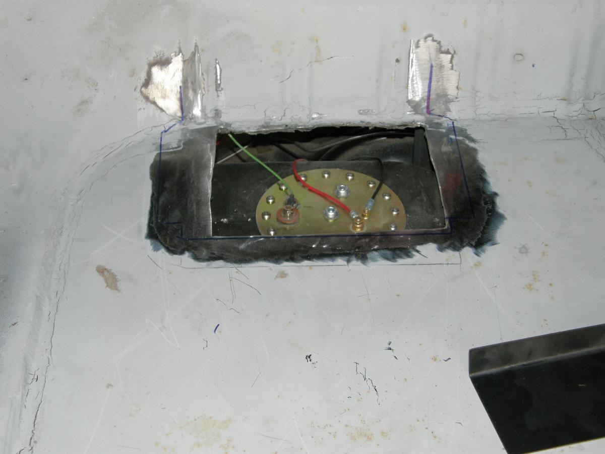

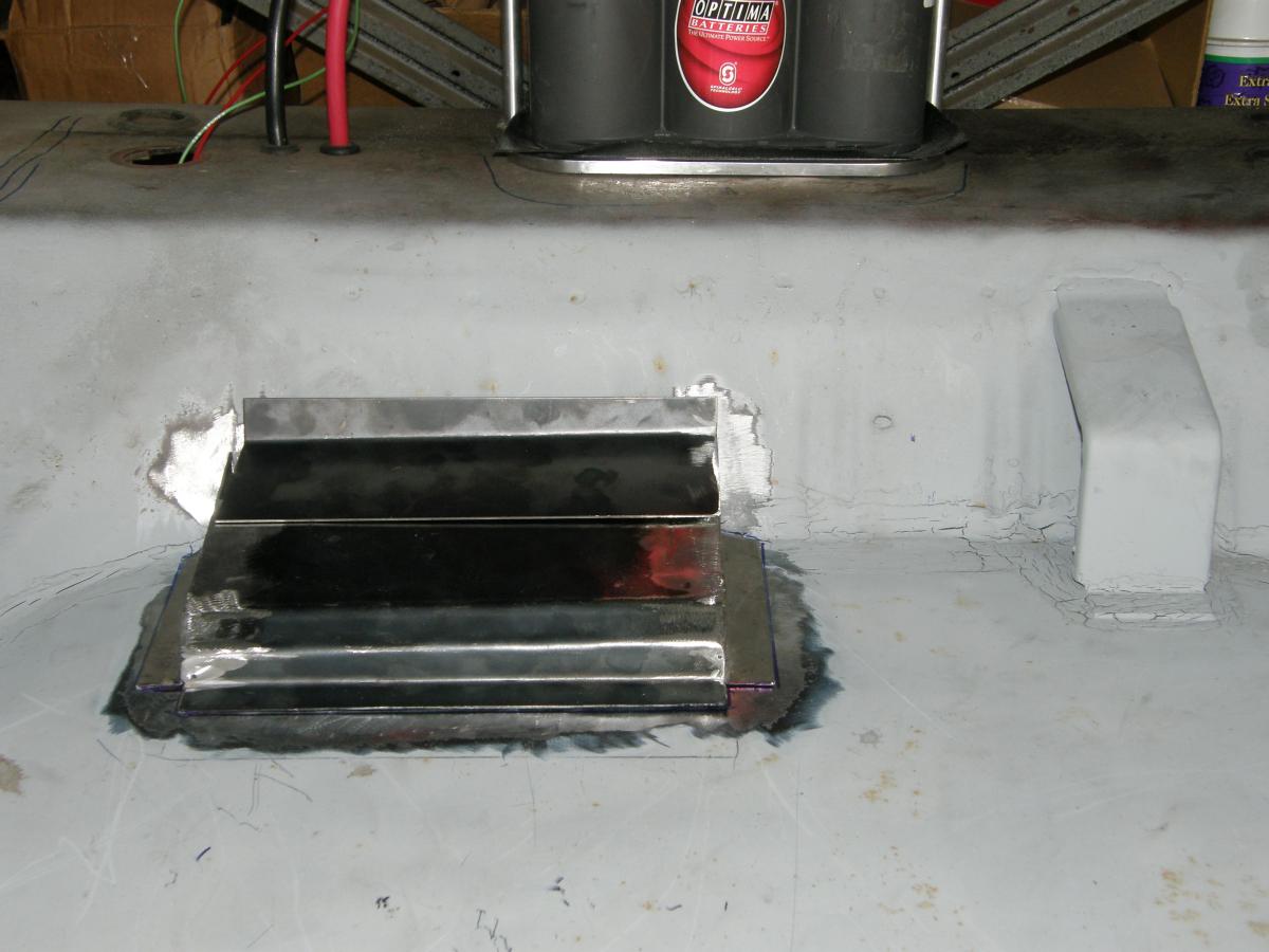

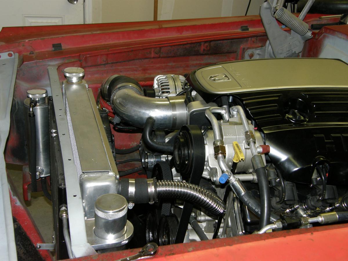

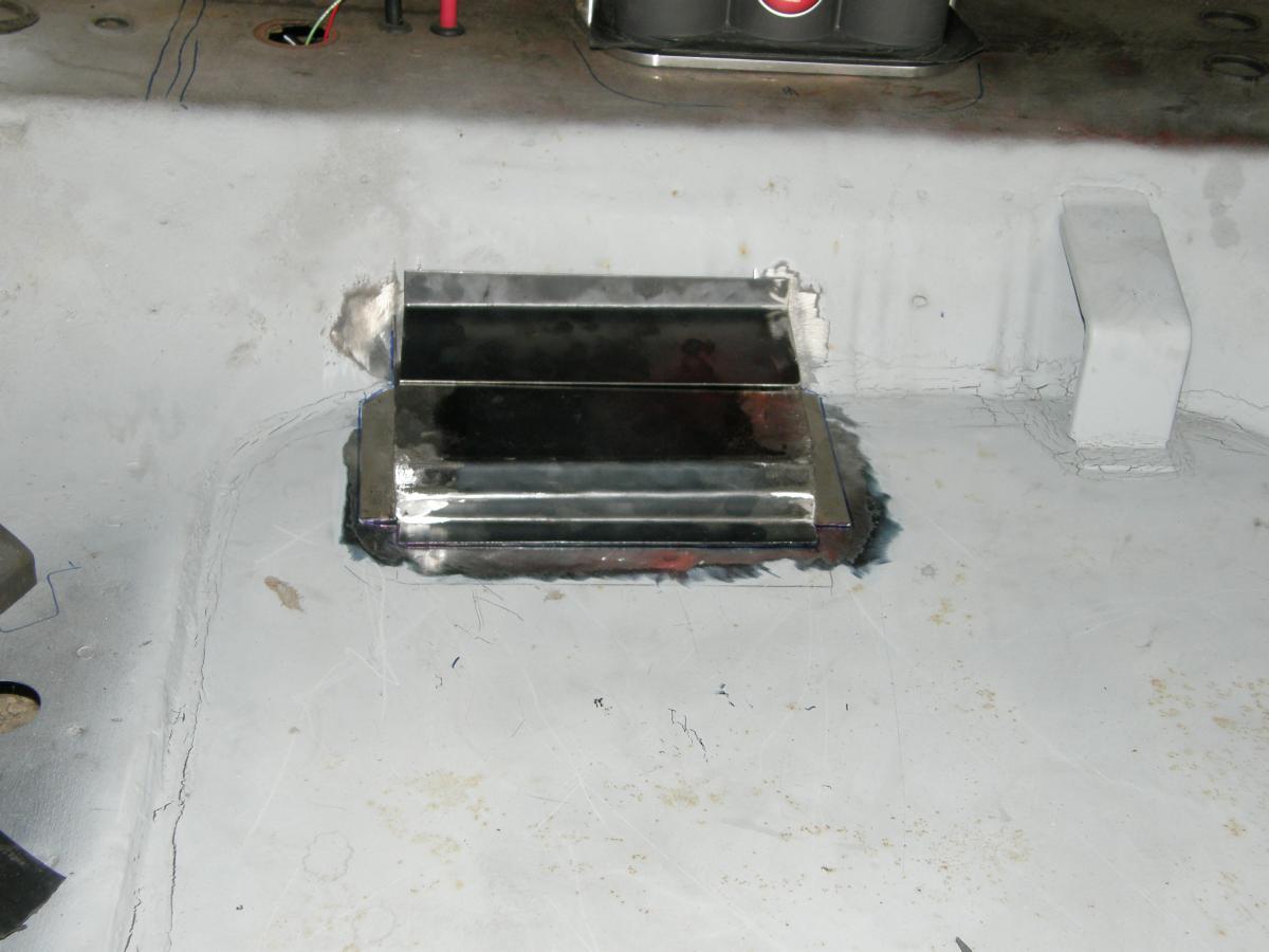

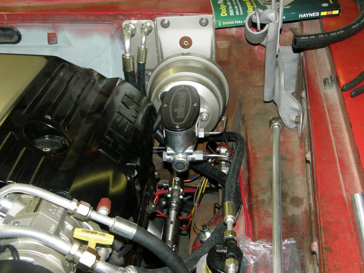

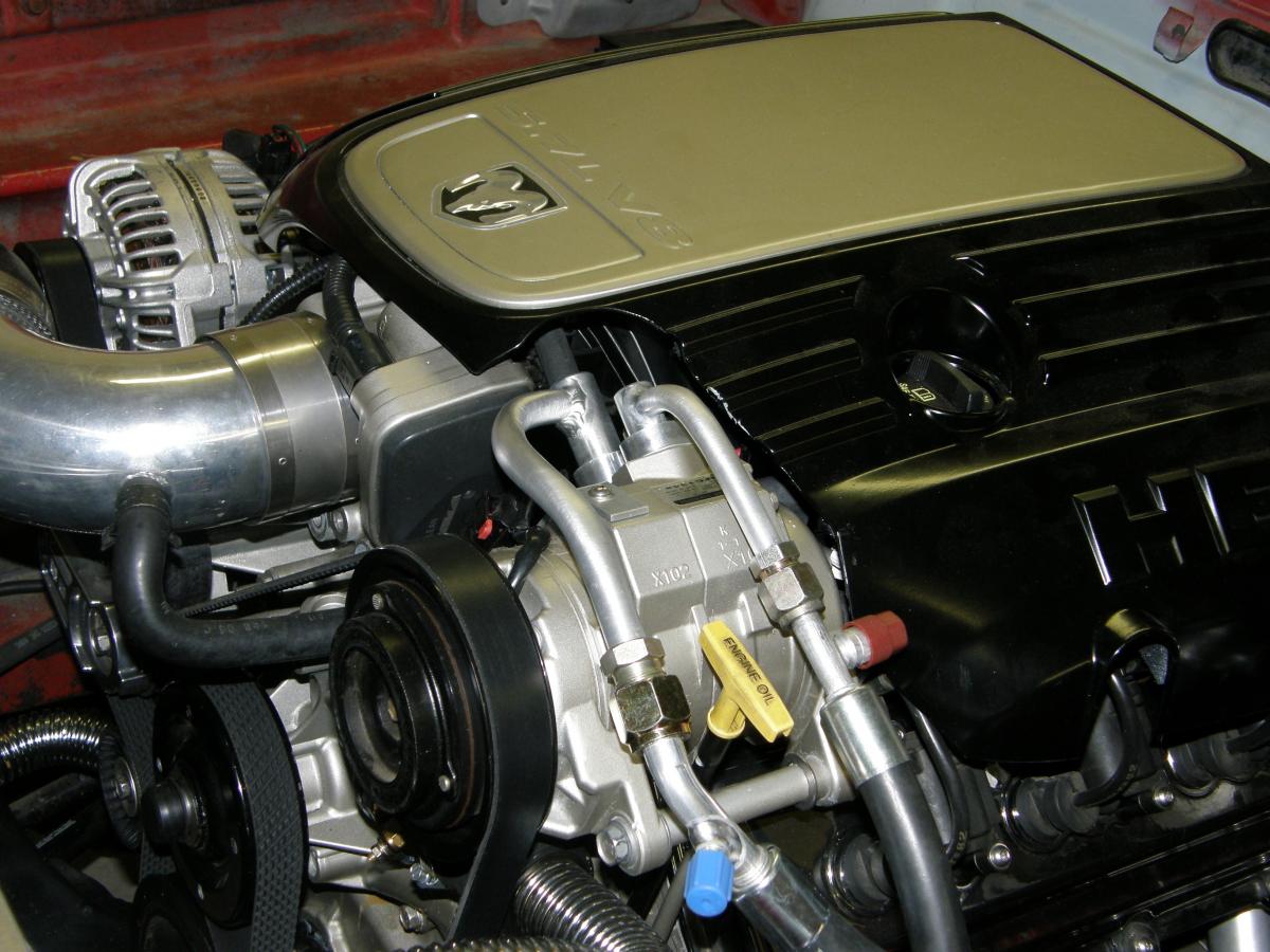

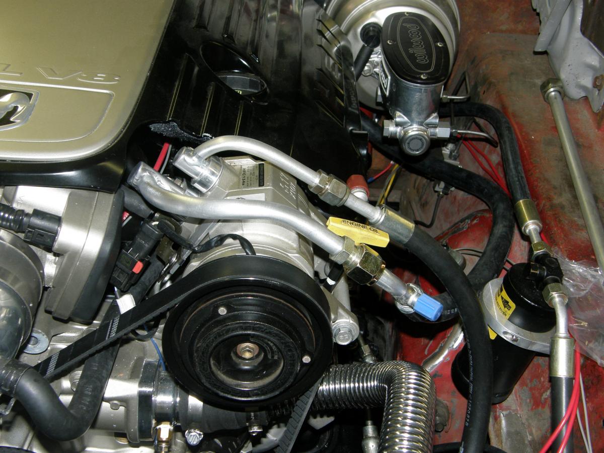

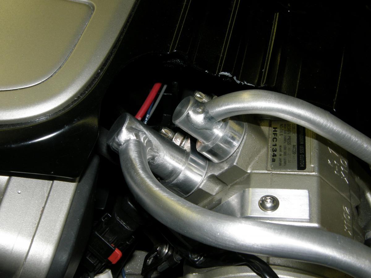

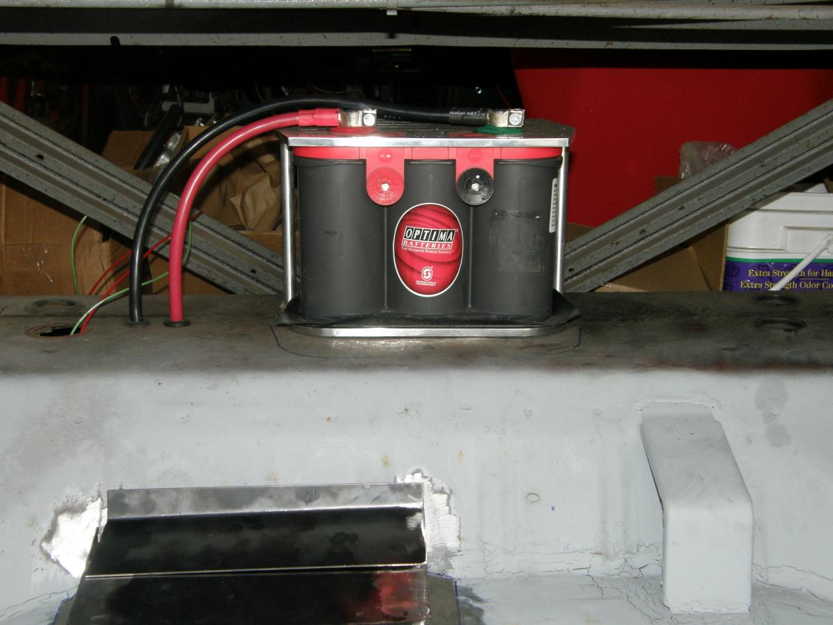

Well, the a/c adapter blocks are finished, FINALLY. My buddy at work tig welded the tube to the adapter block for me, he has about 30 years more experience than I at tig welding. The "doge house" in the trunk is fitted and doesn't look too out of place, but I have had zero time to weld it in, rugrats keep ya busy. The hood is still not not finished, but I'll try to get it done asap.
Now I was all set to get some video of the car running when i got home tonight, but as luck would have it, the damn thing had dead batteries, so I thought I'll just take some pics and post them, dead batteries again. So I go to the junk cabinet in the kitchen, and I'll be damned, NO BATTERIES! l LOOKED ALL AROUND FOR SOME AND THE ONES I STOLE FROM THE KIDS TOYS WERE NOT GOOD ENOUGH. I'LL SEE IF THE BETTER HALF CAN STOP AT THE STORE ON THE WAY HOME AND GET SOME BATTERIES! Anyone else have a good evening?

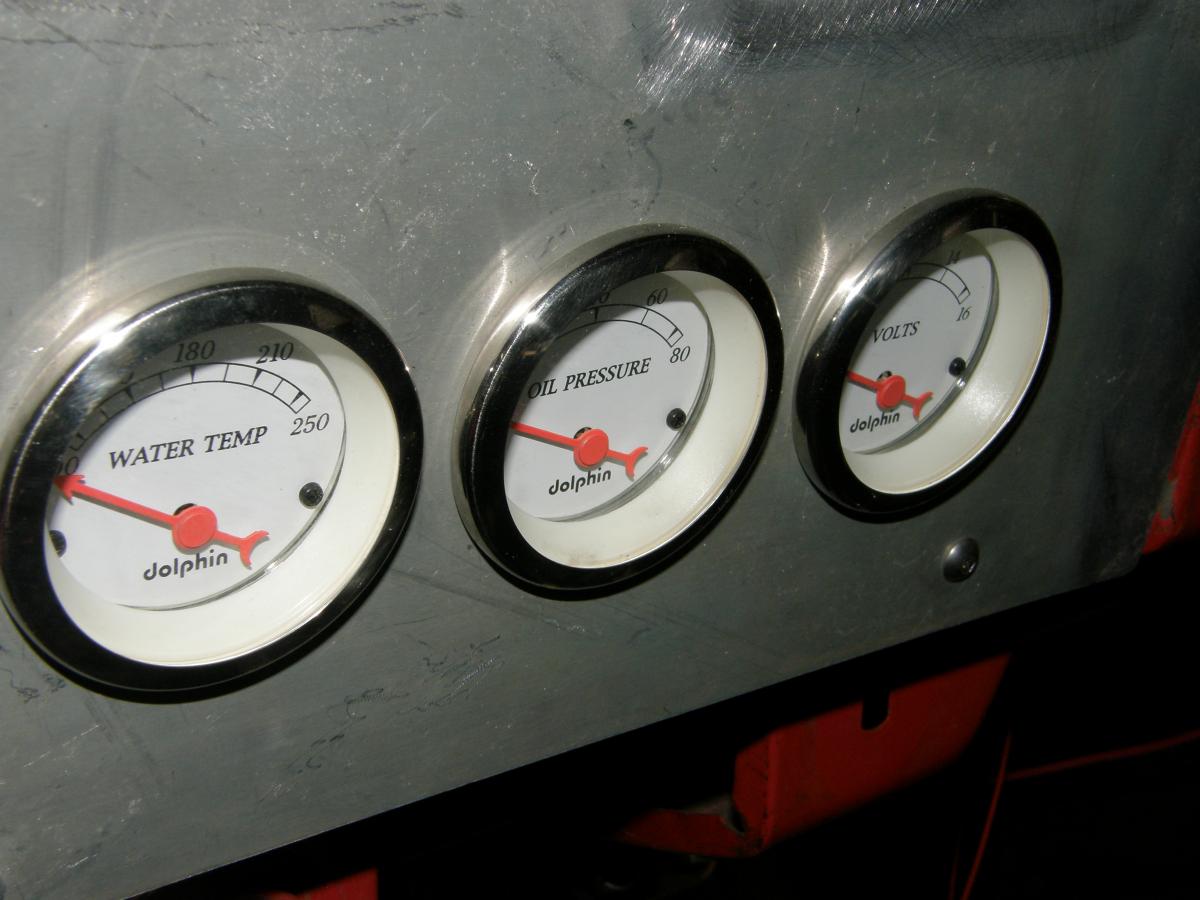

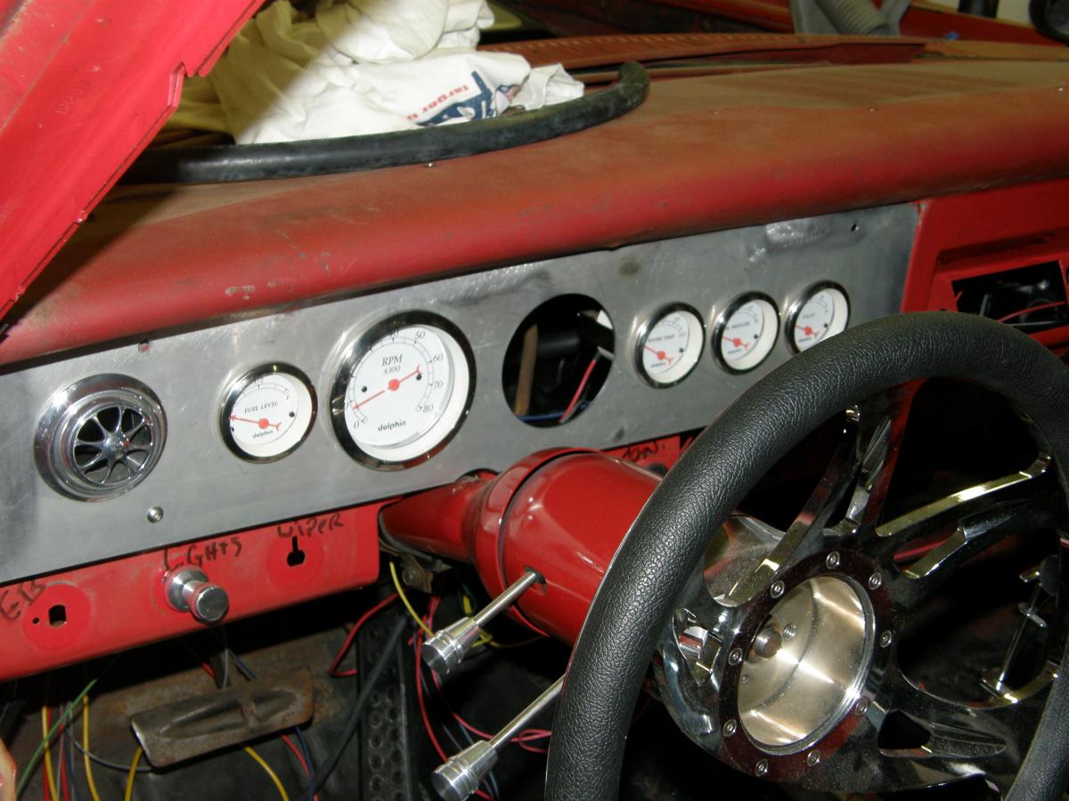

I got some recent pics for everyone to see.

Hope everyone likes what I have done so far.
Hi, your setup look great. Very cool wheels. What or who's computer are you going to use to run the 5.7 & trans ? Can you use the stock PCM as is or due you have to adapt an aftermarket PCM. Thanks for the info.
Stock computers, could not afford to go with aftermarket ( FAST, AEM). This should do for now, cant wait to drive it.
Thanks for the compliment, I'm doing what I can when I can, 2 rugrats keeps me pretty busy.
I will say you are doing a 1st class fabrication job, everything looks top notch. Keep the pics coming. Best of luck on your project.
Yeah, hopefully my taste is not too over the top, and it should be easy on the eyes.
