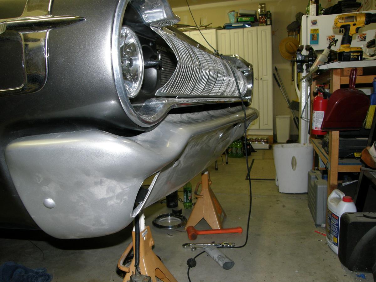

Just got in the reverse lenses and courtesy lenses. Found a place that will rechrome my bumpers for 550. I just might look into it since they are down the street from where I work.
That is a good price if the quality is there Zack.
Yeah Darius, my thoughts exactly. So just to see some of the work that they do, I'm gonna drop off a couple of parts. This will give me a better idea of what they actually can do.

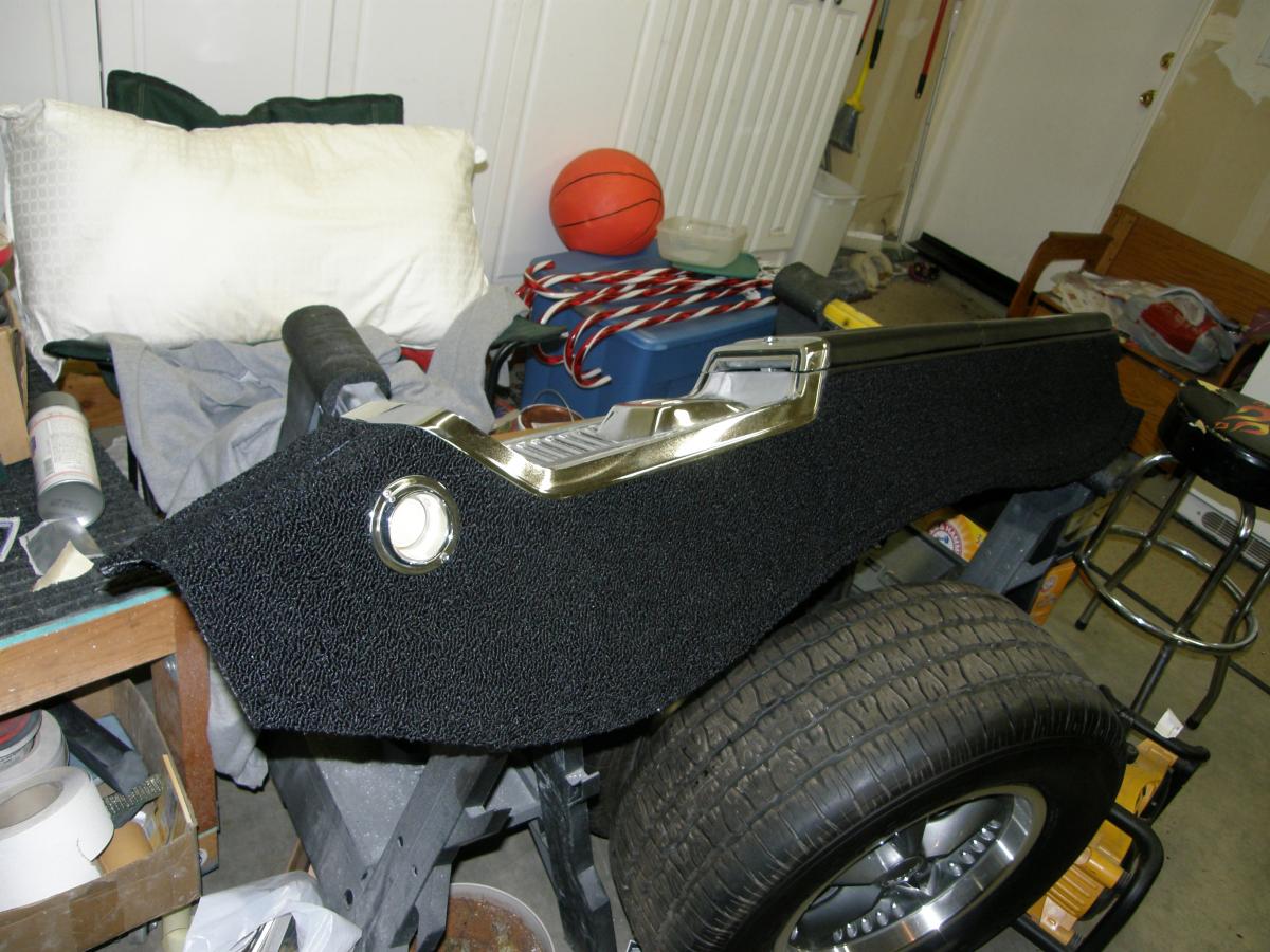

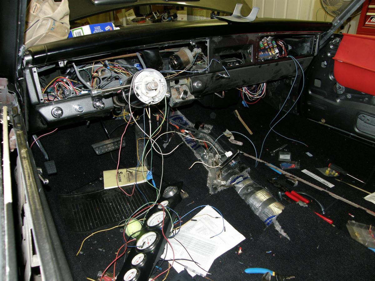

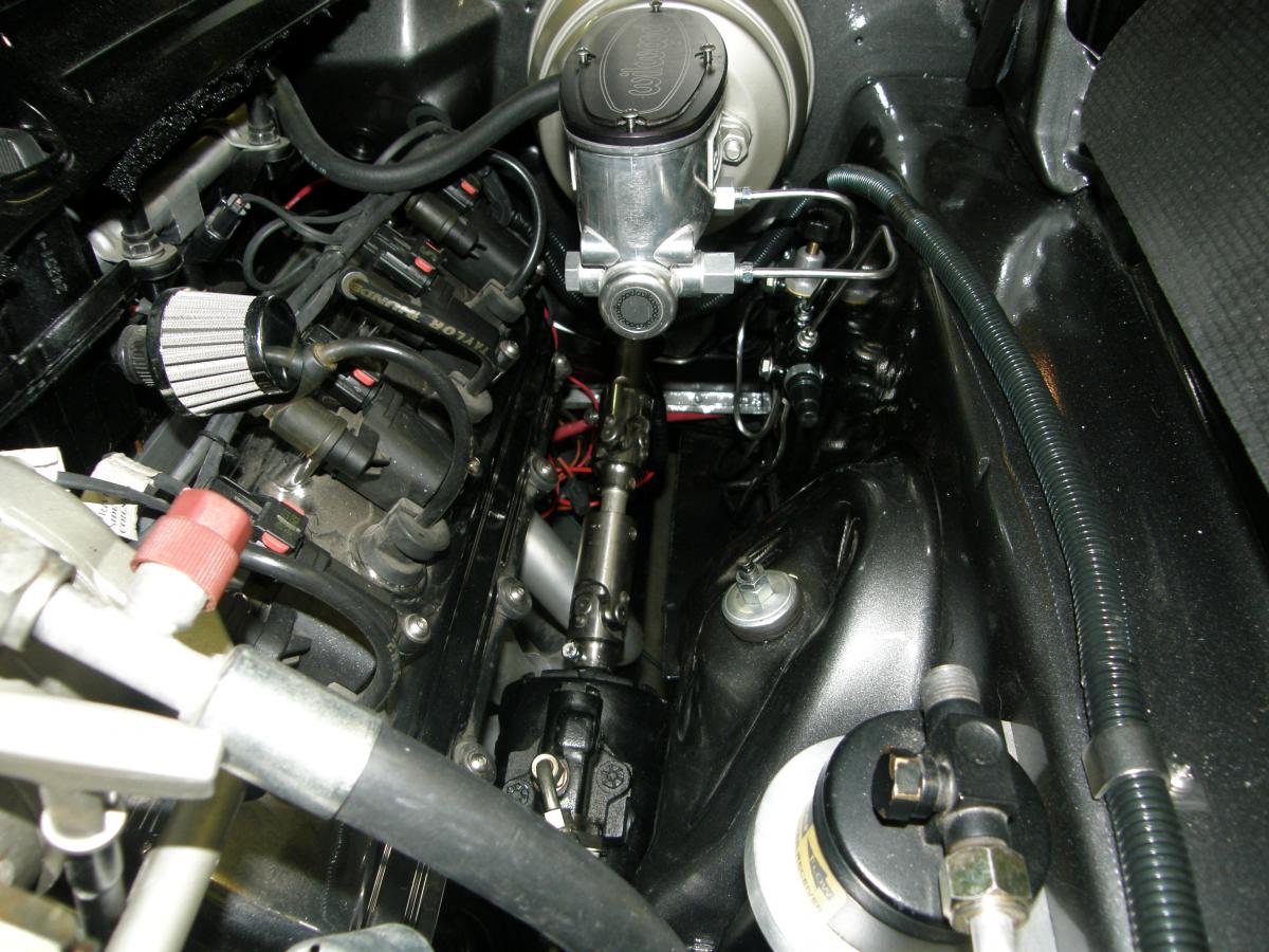

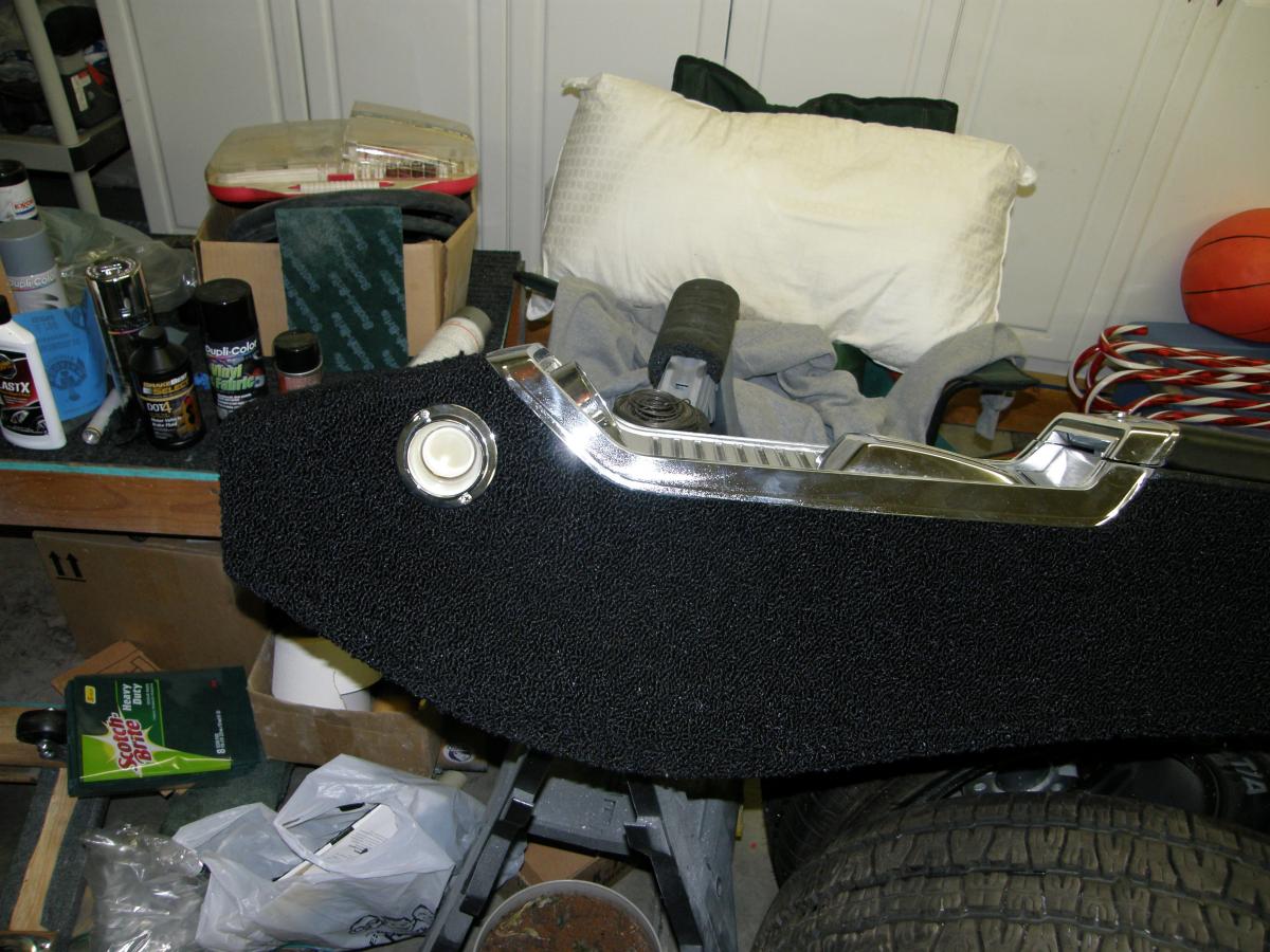

The horns are in between the front splash shield and headlight bucket and they are louder than if they were in the engine bay. Console carpet kit is done and waiting to go back into the car. Finally got all seals for the splash shields so I will finish the undercoating on the fenders. Steering column has to come back out cause I ran the front harness wires under it instead of on top of it. Finally will finish the wiring tomorrow, gonna be a long day doing that and watching the hoodlums cause the better half has to work (hey, someone has to pay to finish this car, lol)!!

SHE LIVES!!!!!! Got it fired up today and everything was perfect, fans came on when they should, good oil pressure, 14 volts, temp just right, and sweet exhuast note. Every light works as it should, so now I can focus on finishing the interior. My buddy Mike put in over 30 hours of his time doing the wiring, about 99% is what he did, I did 1%. No one can twist in a lightbulb like me, lol!!! So now I can finish the 4 wires for the Vintage air myself, yes he left me instructions so I should be fine. If I can figure out how to post a video, I do it so everyone can hear the little elephant.
