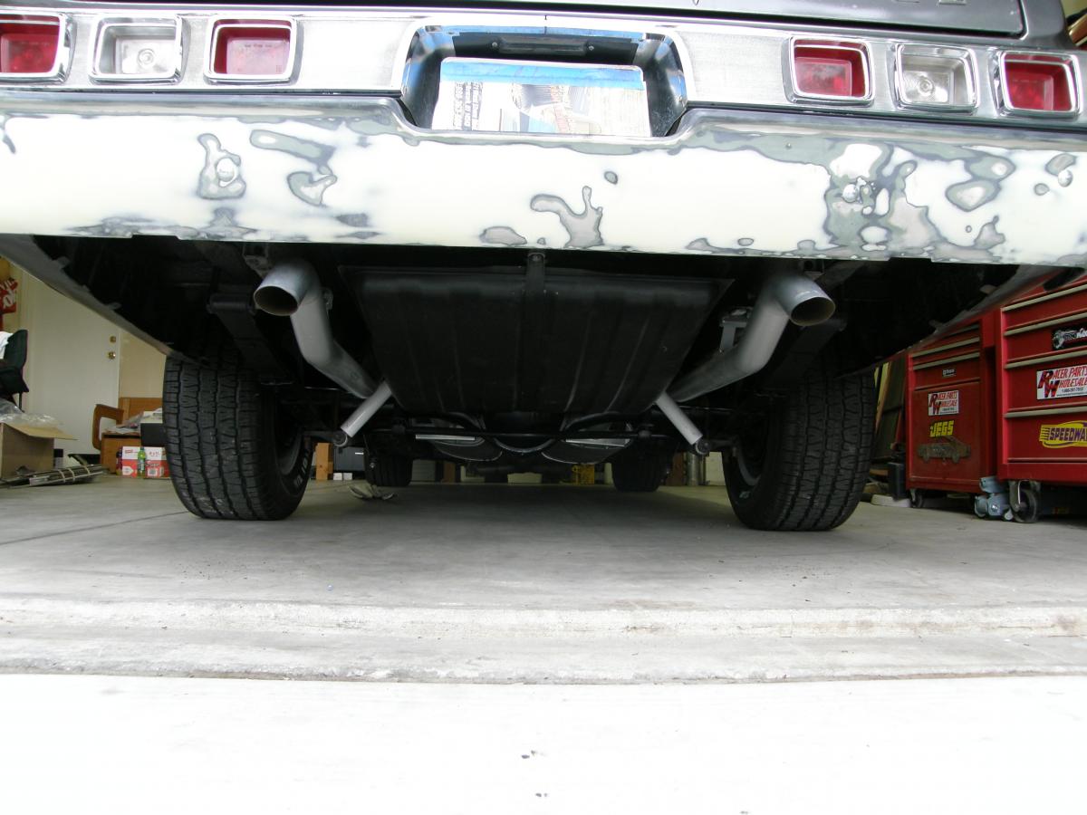

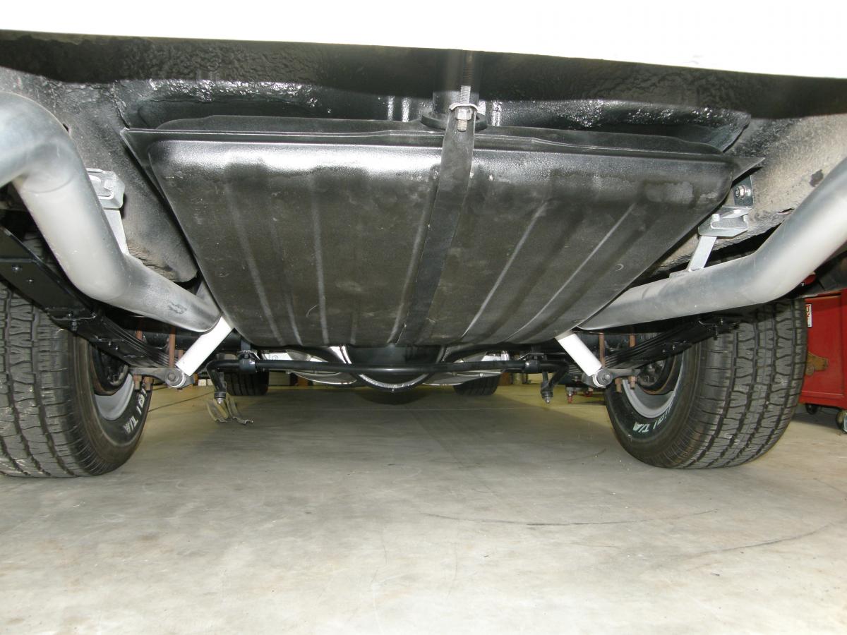

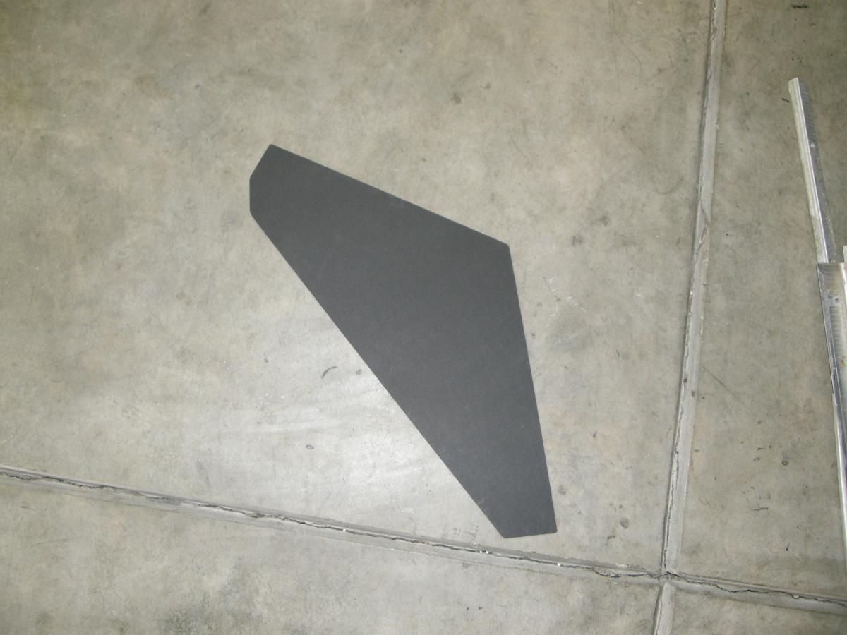

Here ya go Joe...just for you...lol!!!!

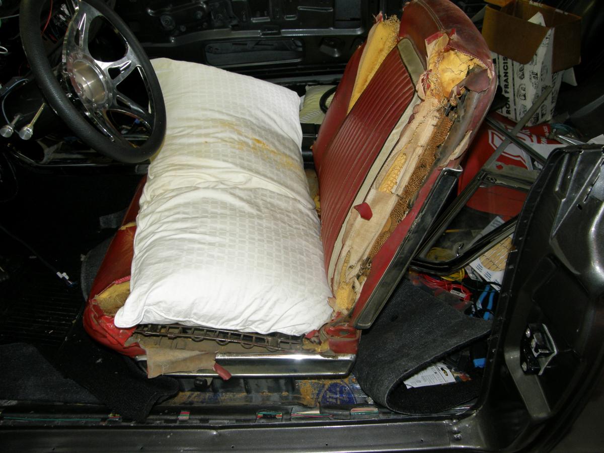

If you got a 64-65 2dr hardtop, I will take the measurements of the sail panel board so you can duplicate for just a few dollars instead of buying it. Also my 2 yr old daughter, she loves to "sit and drive" while I work on the car. I will be selling the seats real soon, as soon as my other ones are done. Hope you enjoy the eye candy.

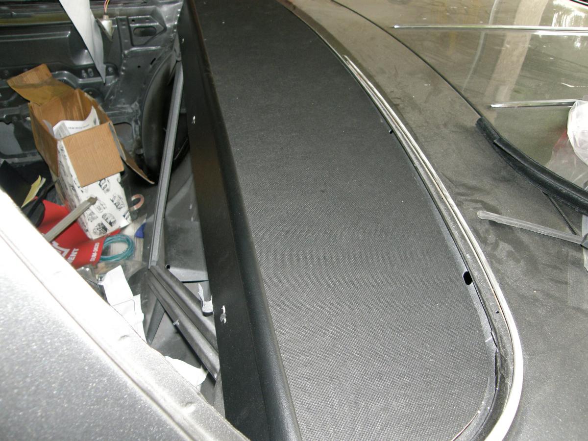

Hey Zack what kind of material is that sail panel made of? Thickness ? I have mine that I can use as a pattern. The ones in my car are a little wavy and should probably be replaced.
Joe, heres goes nothing. The sail panels are "about" "just over" "a tad bigger" than an 1/8 inch. My dad stopped by today to help me get it installed and 95% of it is done. I could not believe how simple they are to install. I just have some trimming of the excess and gluing the c pillar overlap to do and it's done. We started around 3 and he took off by 5, and I forgot to take some pics, so I'll get some tomorrow and post them. Just as a side note, if your old ones are half way decent to use for a pattern, get some backerboard and make new ones. I would have done that but 99% of mine were missing.

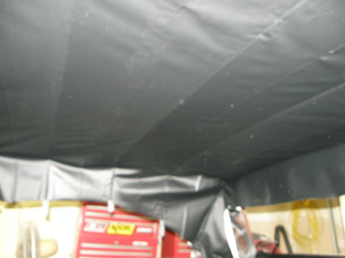

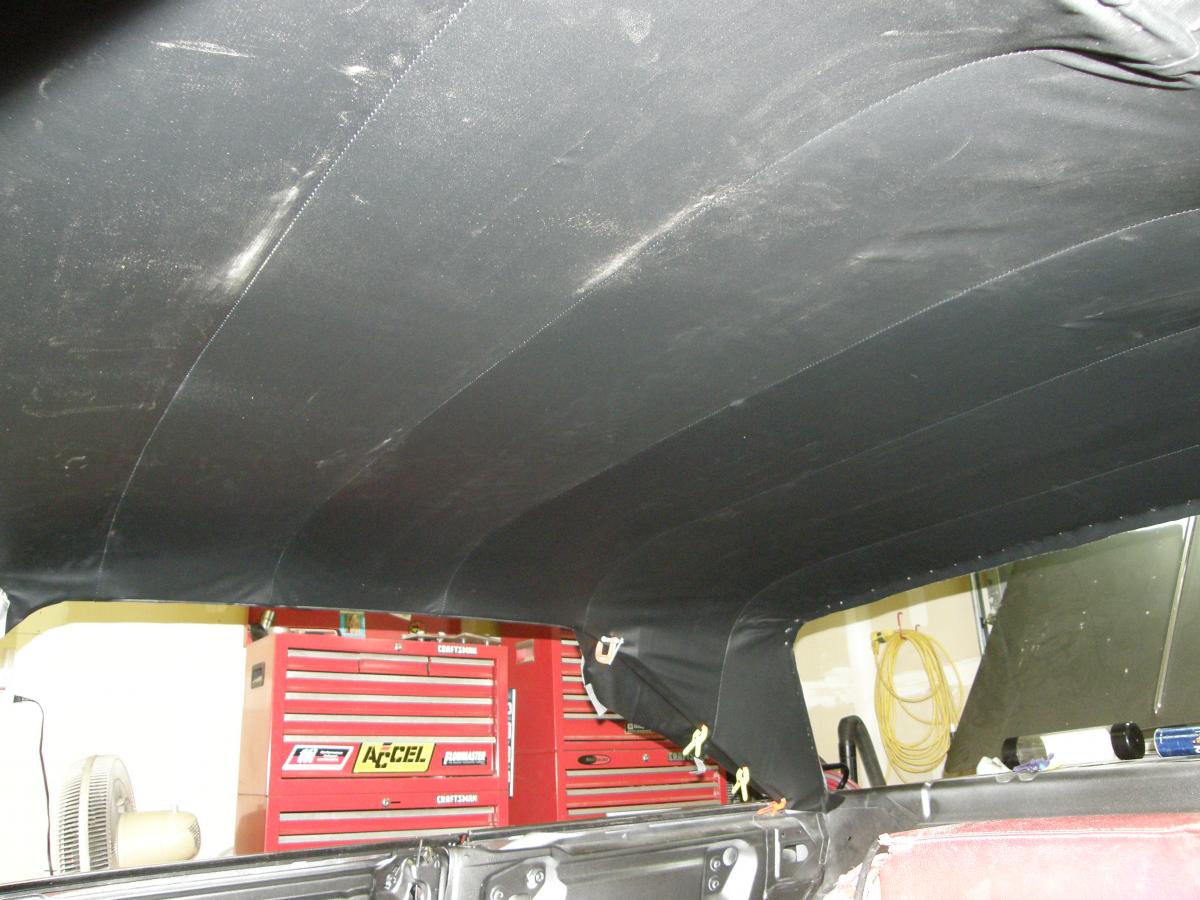

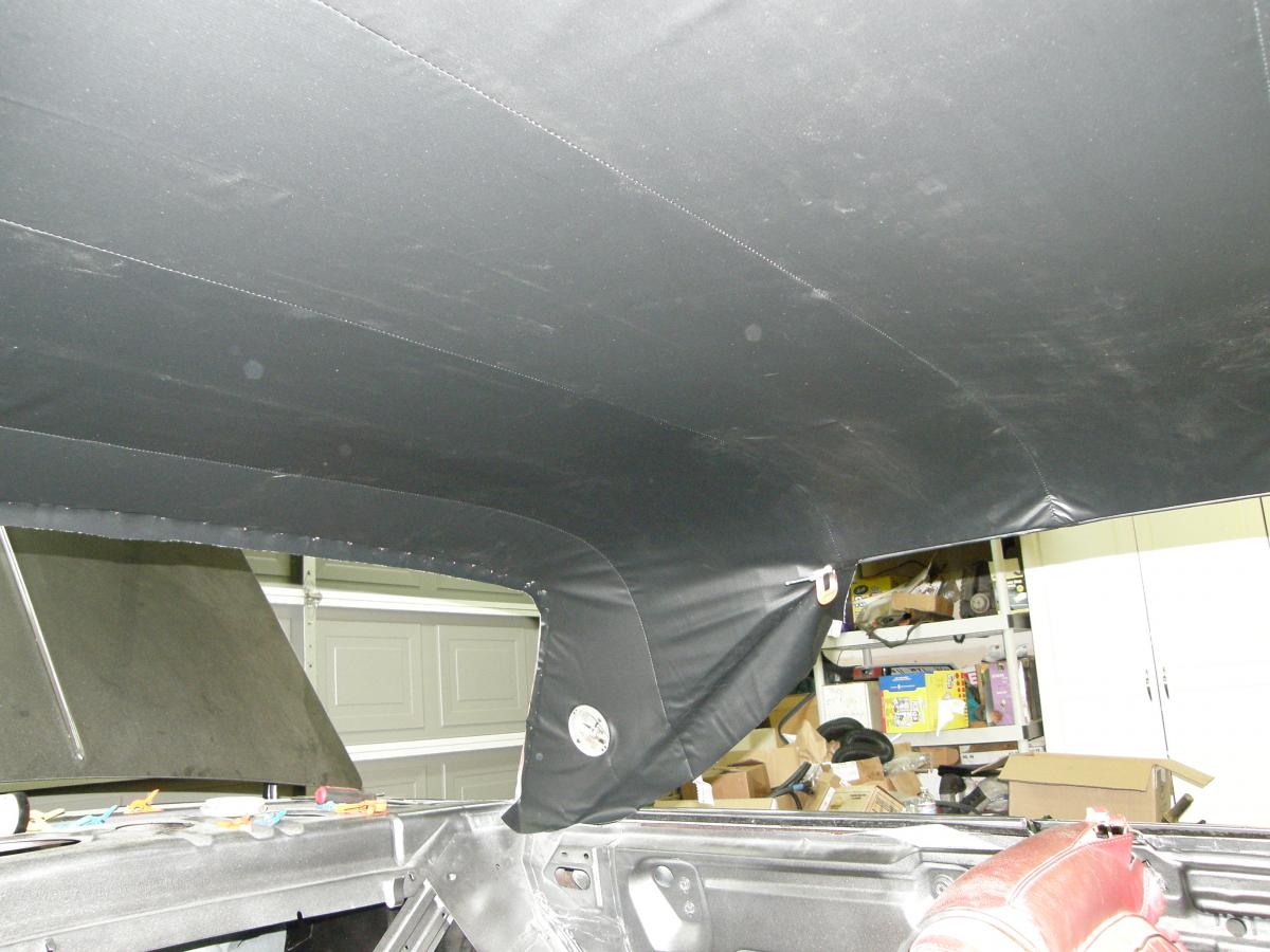

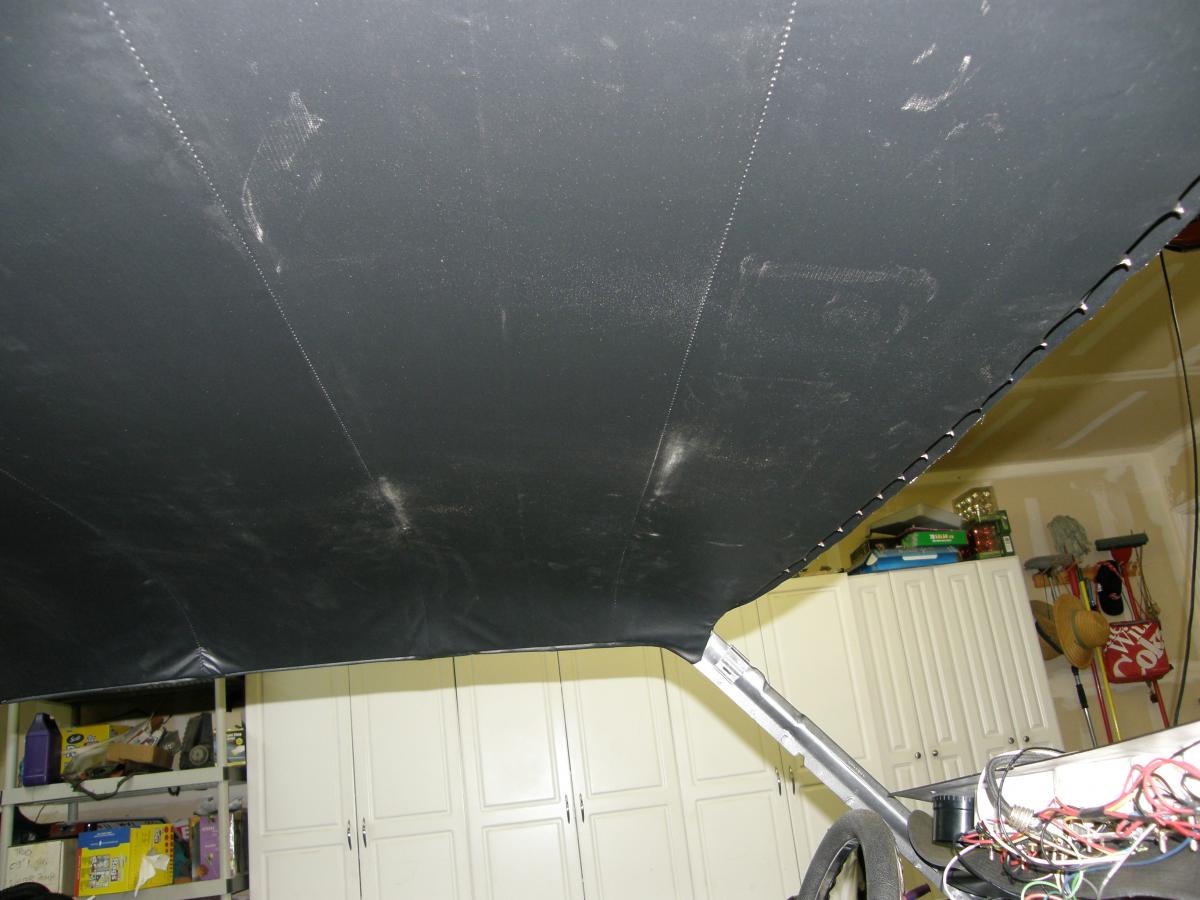

Heres a few pics of the headliner. I does need more tlc, but I'm on the right track.....enjoy.

The headliner is not perforated, it was only 30 bucks so I got it, besides, there isn't to much that is original anyway so I figured why not save a few bucks.
Bumpers are ready for paint. Still working on the headliner, trim piece has to be polished and put on, then I can finish the headliner and move on. Getting ansy to "test drive" it again.
