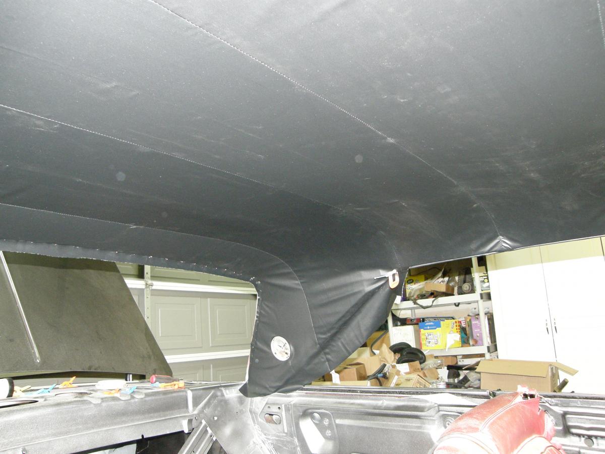

Headliner is finished, now the interiot chrome has to be redone cause it's so pitted and rusty I could not get it clean enough to be good for a saturday night show.

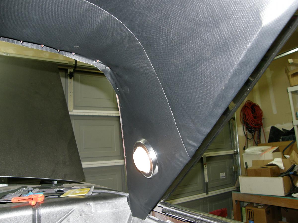

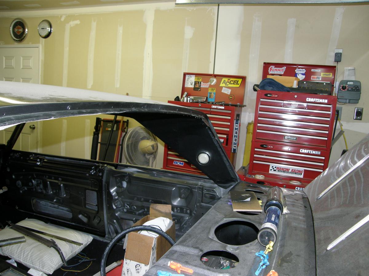

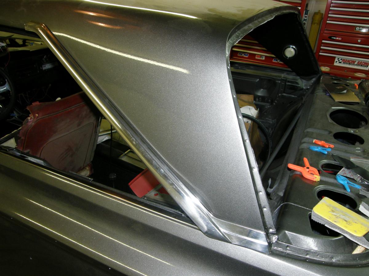

headliner installed, hope all the wrinkles will come out with some heat and the trim installed. also the outside trim piece that has to go on first because it has a stud that gets tightened fron the inside.

Got my seats yesterday, they look good. Figured out how to install the roofrail trim thanks to a few members on fbbo. Brakes are working perfect, turns out the adjustment on the booster side need to come out alittle. The factory headlight switch is now being used so all the knobs and besels match. Got alot stuff done today, hopefully get more done tomorrow.
