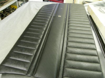

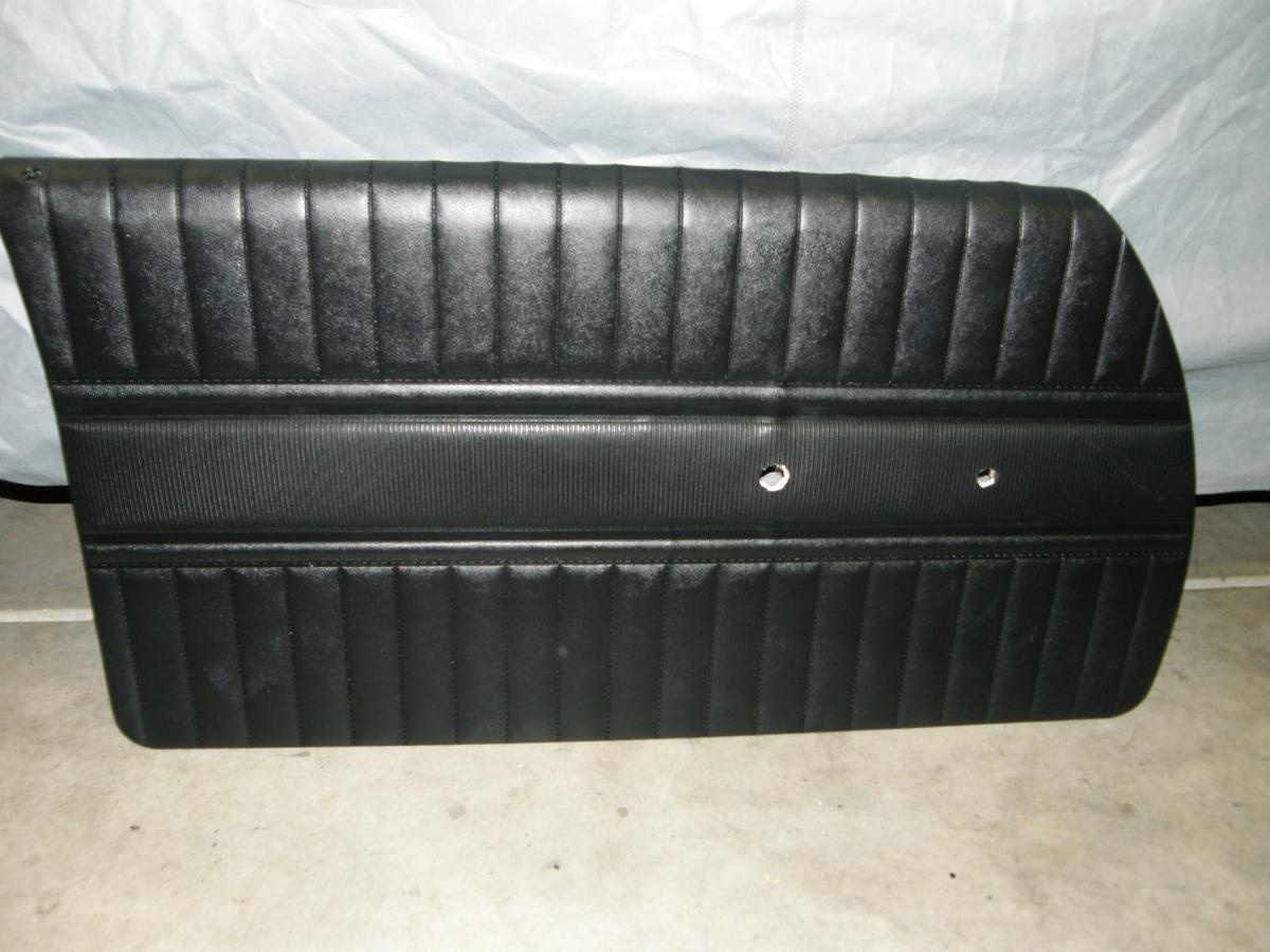

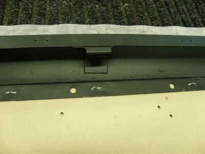

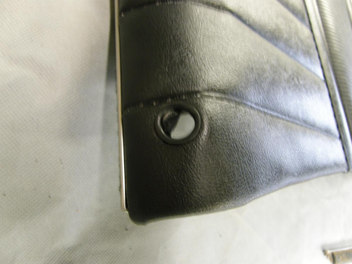

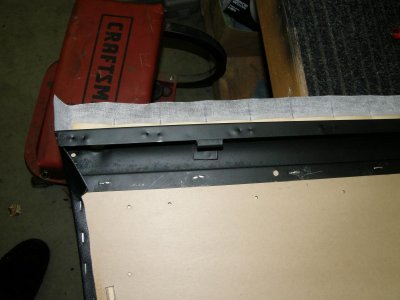

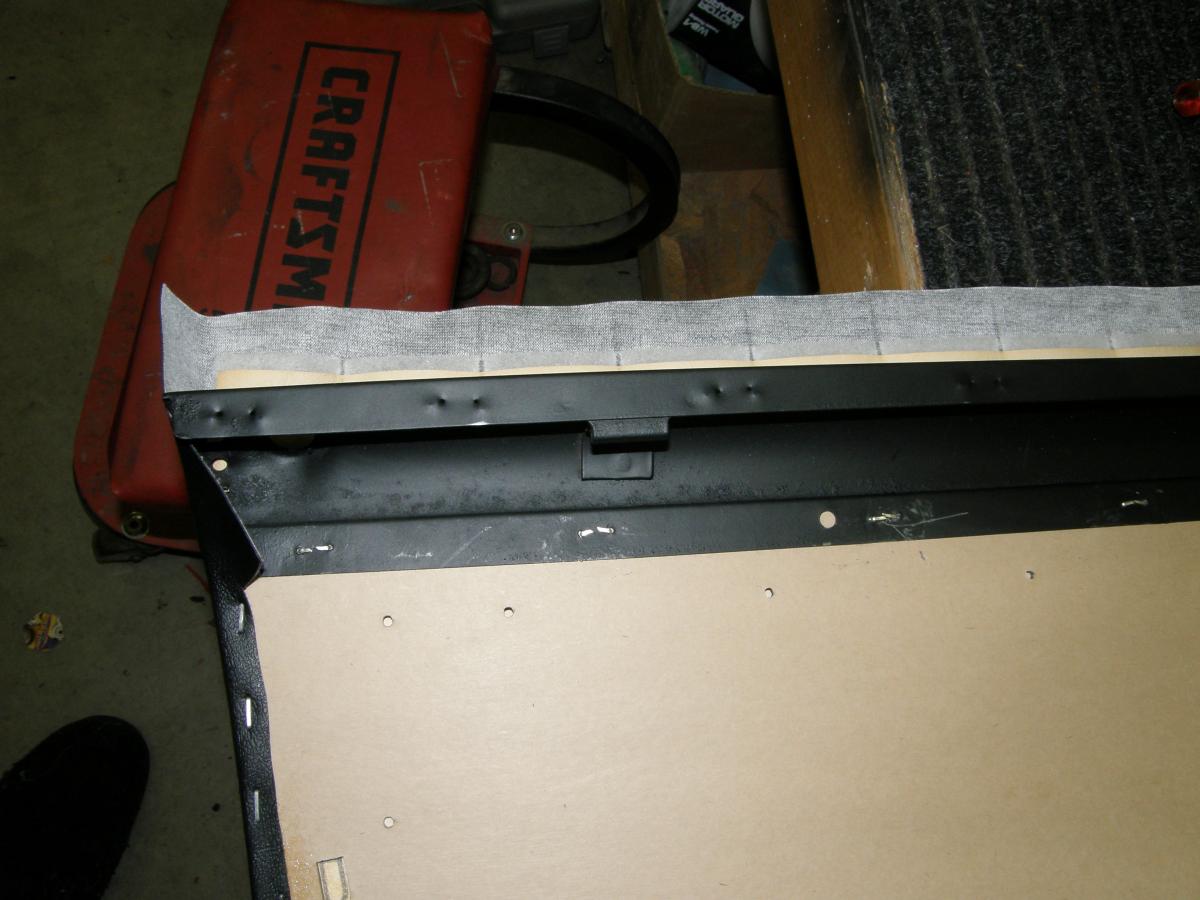

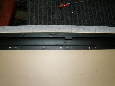

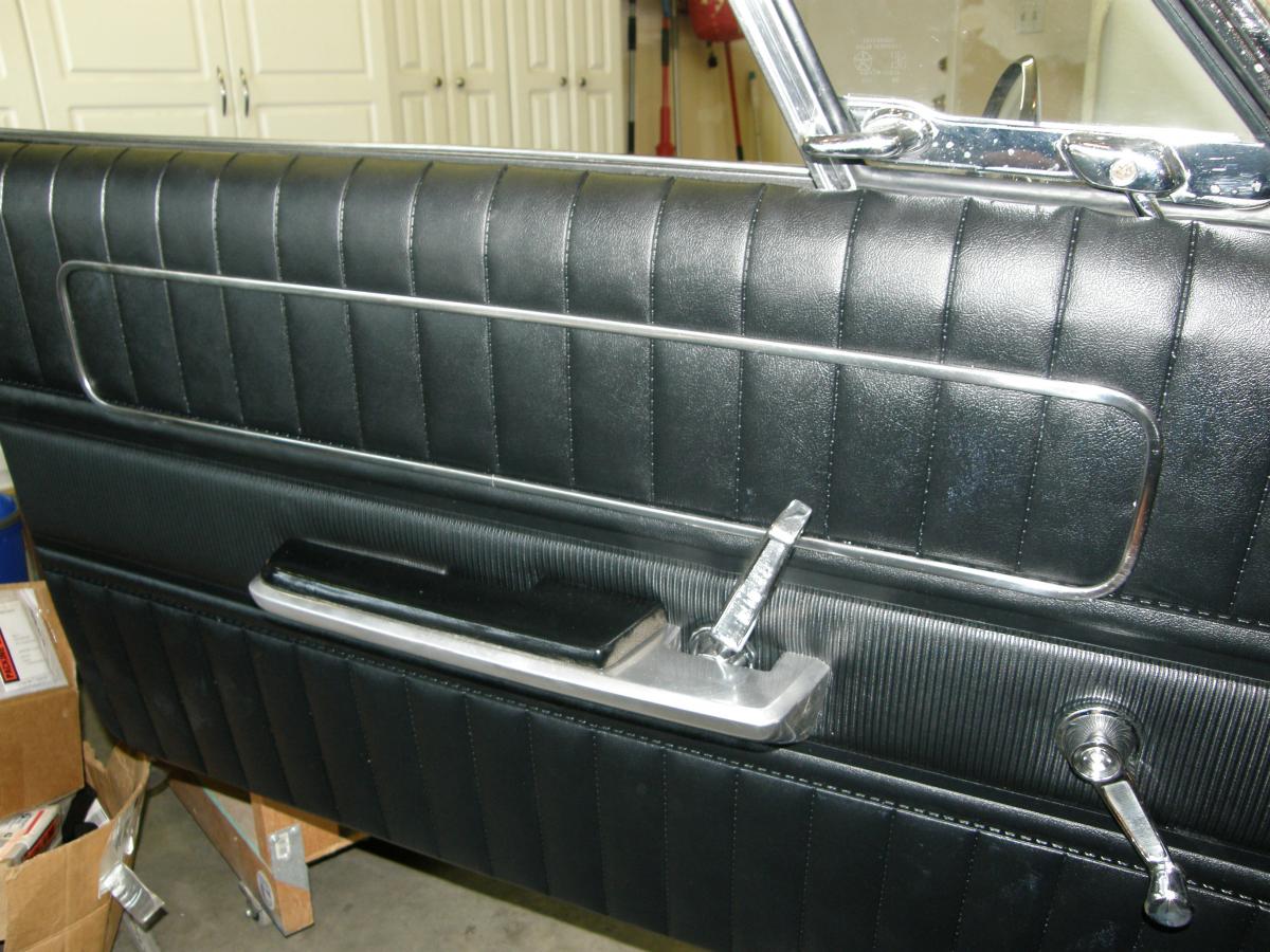

I finally got around to the front door panels. I got these from Legendary in the clearence section for next to nothing. I didn't want to use rivets, so I used staples just like the factory did. I took out the old staples and then lined up the metal top to the door panels and used the smallest drill bit that fit thru the old staple holes, drilling thru the door panel. Then I pushed the new staple up thru the holes and bent them over using a hammer and dolly. It worked out really well and I'm pleased with the results.

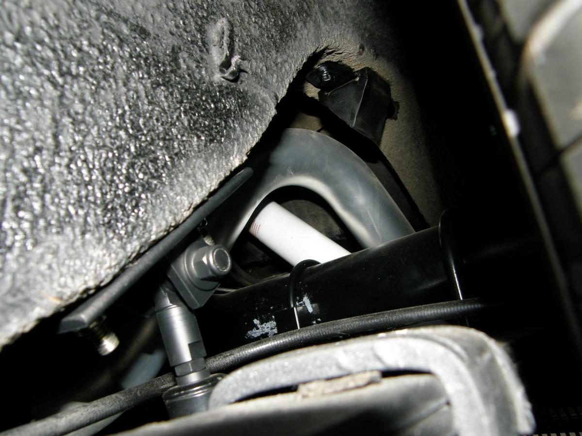

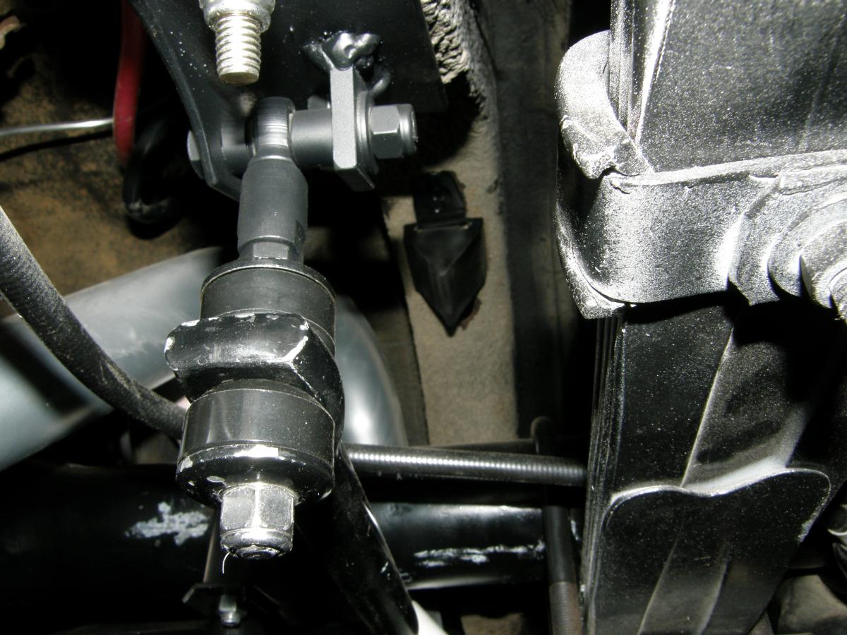

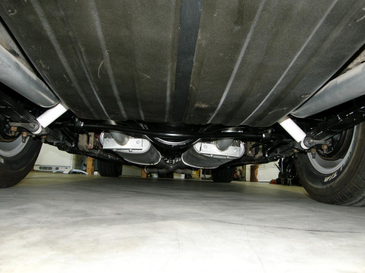

The "new" rear sway bar mounts are done. These look better than what I had done before and are much stronger, and offer better articulation, cant wait to try them out on the street.

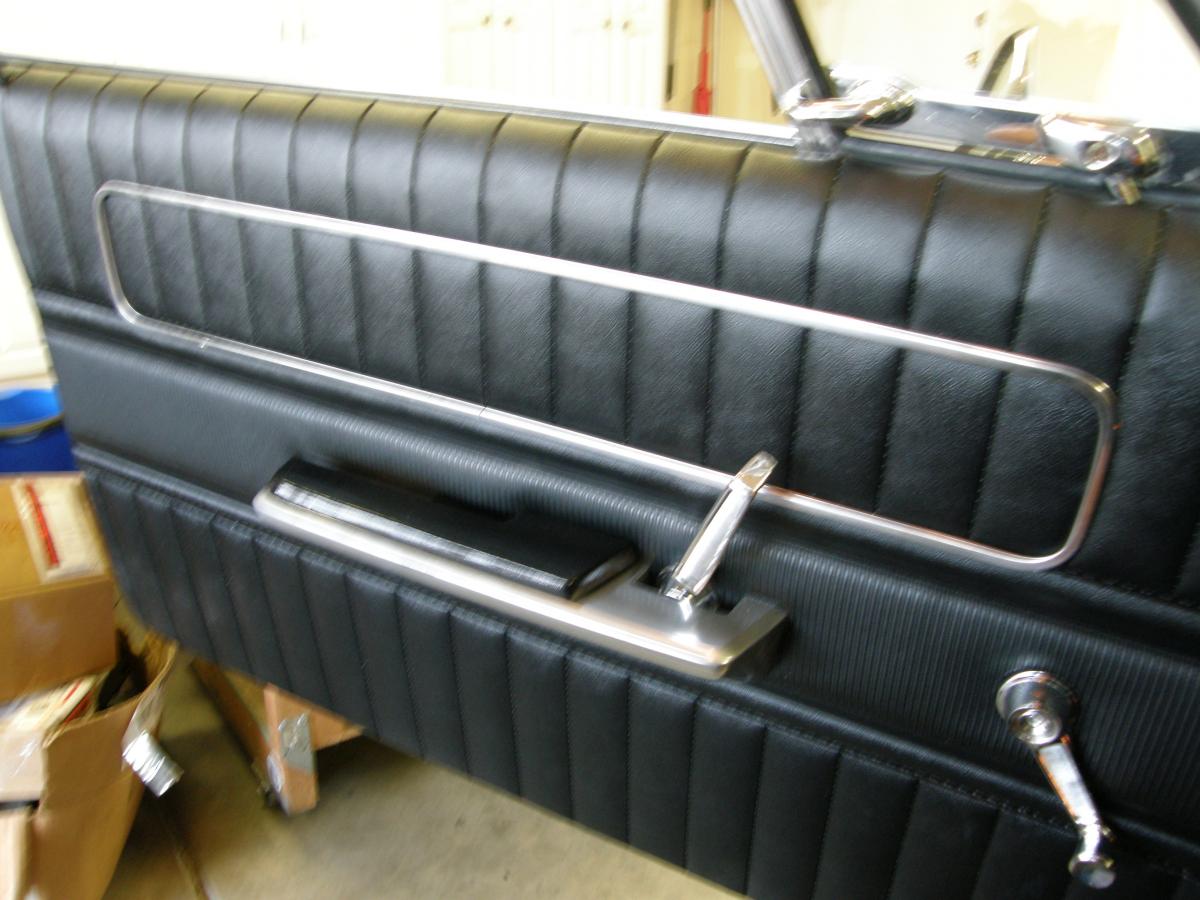

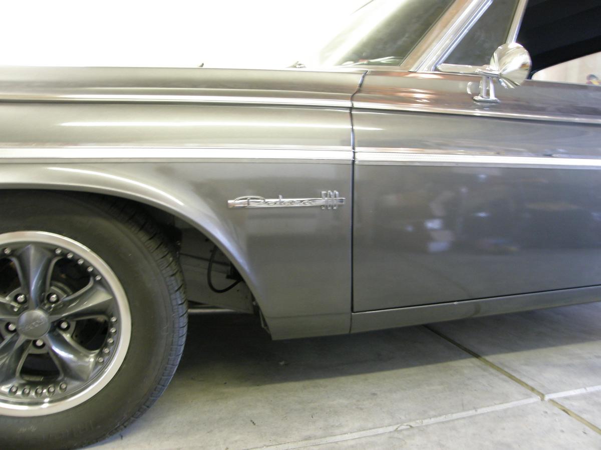

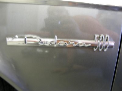

I finished the passenger side door panel tonight, just need to put on the window fuzzy. Also got some "new to me" Polara 500 fender emblems so I cleaned one of them up and it looks decent according to the better half. New door lock knobs are being made on the lathe at work, yeah I can buy them, but this just adds to the "looks factory, but yet different somehow look".
Thanks Tin.
Totally finished the front door panels and I put on the Polara 500 trim even though I put in Coronet 440 style panels. Gotta say, they do look bitchin'.

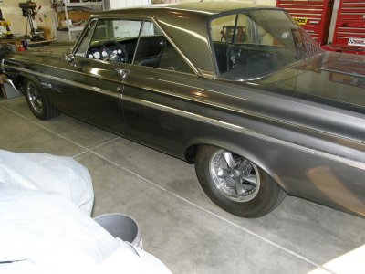

Put on the new to me emblems and the front door panels. Also a pic of the sway bar, not that it can be seen all that much.....enjoy!!

Well Joe, I did take it for a drive around the block grandma style, all the local police and highway patrol guys were home (cars parked in the drive way) so I took it easy, but did manage to get on it and broke loose from first to second. I tell ya these Hemi's like to run.

what size of staple did you use or what kind? was going to use rivets but it doesnt look to hard the way you done it. thanks
The staple is 3/8 wide and then bend over the rest. I used heady duty staples from homedepot.
