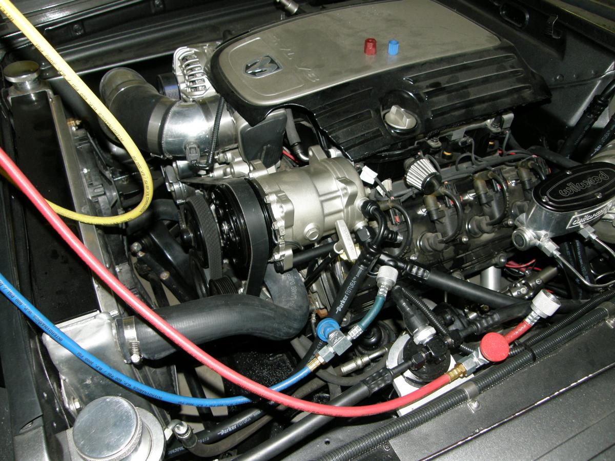

Well I did the "guy thing" AGAIN!! The instructions for the Vintage Air were "glanced" over and I went to town putting it in. As you all know I was finally able to charge the system awhile back and got 45-50 degrees from the vents. So I try the ac this past weekend, and the compressor wont kick on. I assumed it was cause I got some air in the lines and also not enough freon. Turns out I mounted the condensor upside down "should have read the instructions more carefully" and I mounted the binary switch before the drier. So tonight I took the condensor out, reinstalled it the right way, and mocked up a new hose and ordered a drier with a binary switch mounted to it.I'll get the new hose crimped and vacum it down this weekend and see what happens. Now all you people who want to give me static for releasing some freon into the air, I'm sorry.
I HATE AC WORK!!!!!!!!! No matter how many times I have made the compressor adapters to fit the compressor the always leak like a mutha. The vacum gauge shows that there isn't any leaks but when I start putting the freon in, I see start to leak out the soldered joint. I bet I have a 100 bucks in freon and it still isn't working. Anyone know how to tig thin wall tubing to a block of aluminum???
Since I have been having so many problems with the adapter blocks to the factory compressor, I have decided to put on a Sanden compressor since there are numerous adapters and hard line kits for those. Time is running short to get this done by the first week in Oct. to make the Fall Fling in Madera on Oct. 8.

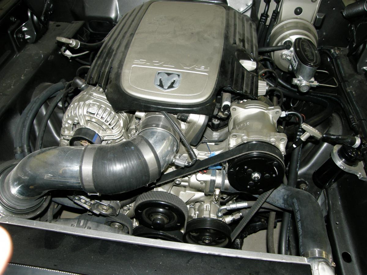

New sanden compressor is mounted, had to modify one bracket to make it fit, and of course this lead to needing a shorter belt. Turns out my dad kept all the belts that I bought when I first started this project and wouldn't you know, one of them was the perfect size. Legendary said rear panels will go out on next week, cant wait to get them installed.

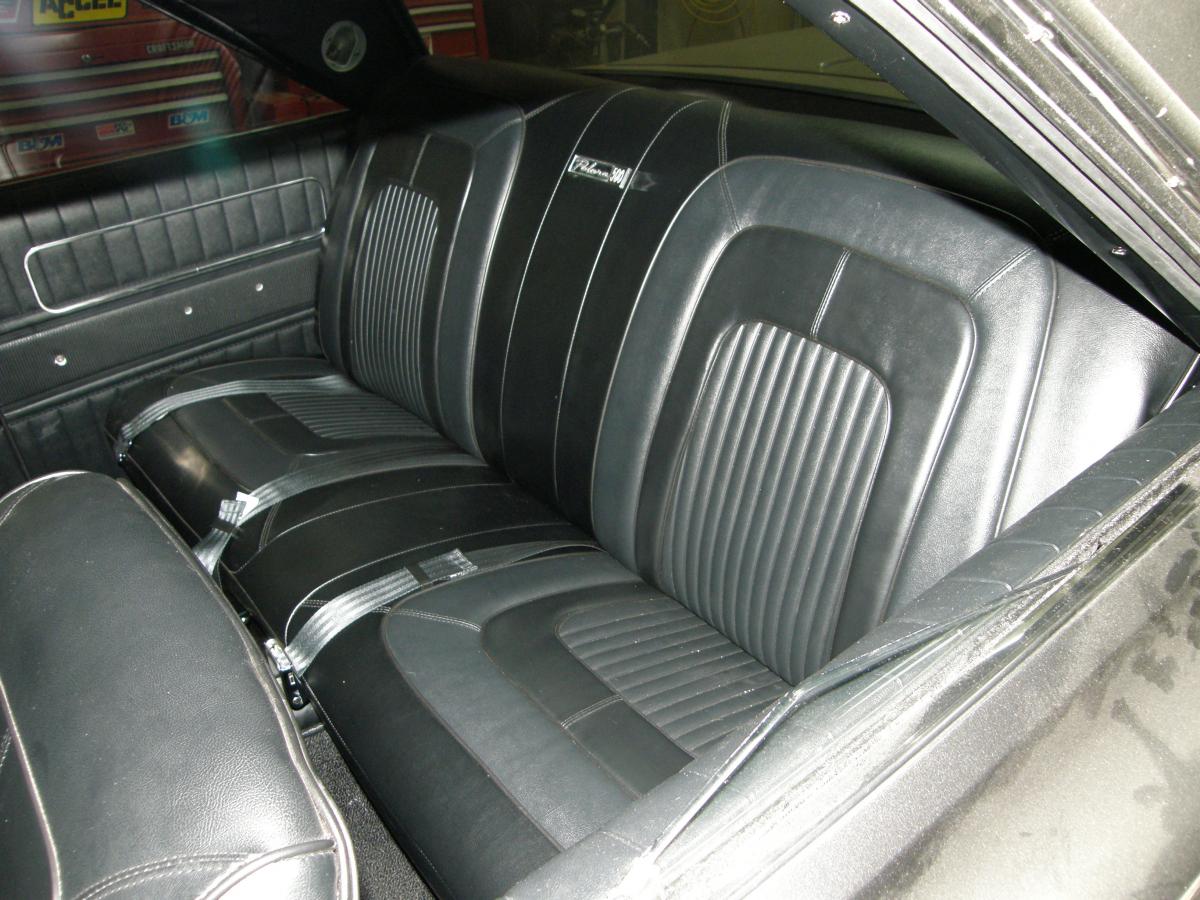

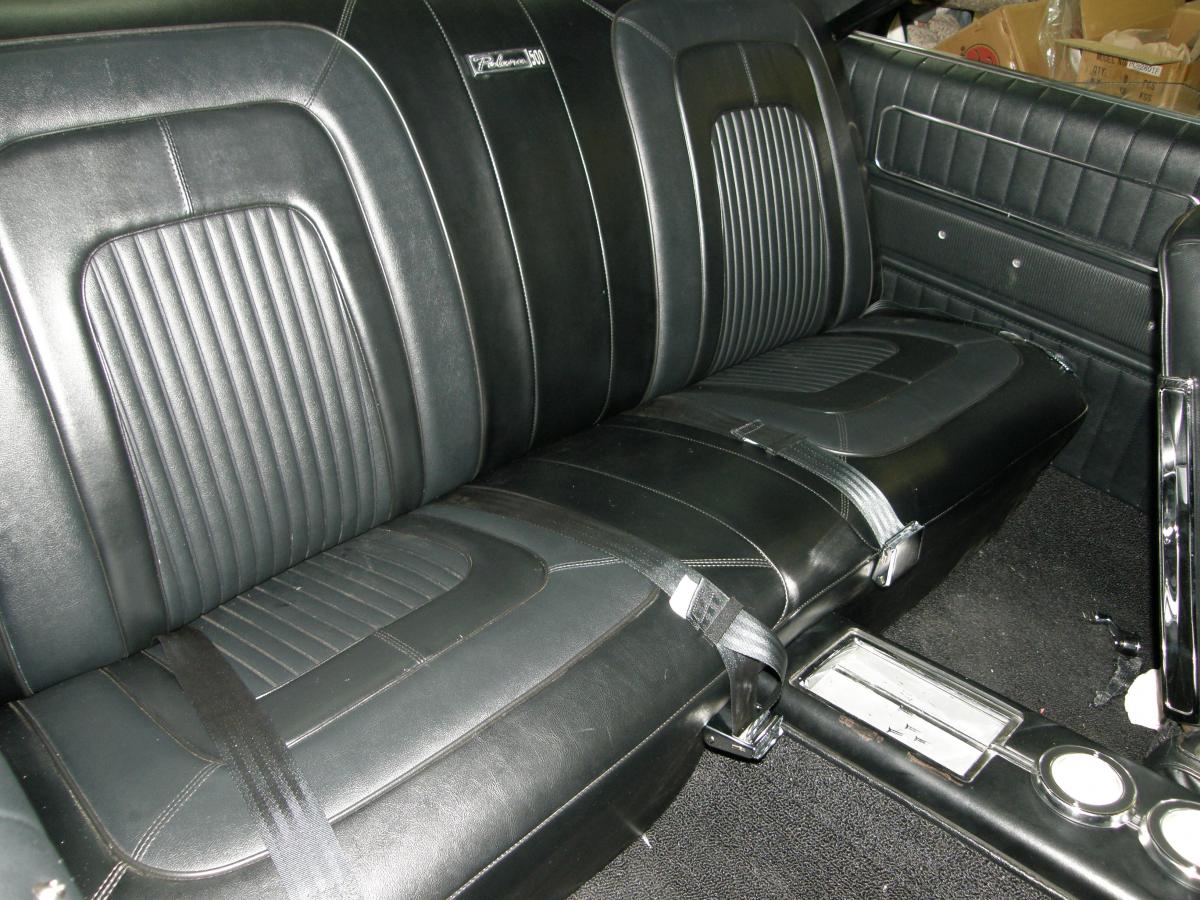

As some of may notice the rear seat covers are not totally correct and also these are for a Coronet vert, so I say they came out darn good considering they had to be modified to fit the hardtop seat frame. The rear panels are in and they are also for a Coronet 440, but I got a killer on them, so thats what I used. I did take the trim off my original panels and put them on the new panels to give it a bit of flare.
The Sanden compressor fit really well, just had to shorten one bracket and bingo, it fit. So hopefully now there wont be any leaks like the factory compressor had which I now have sitting on the shelf. Still have to hook up the wires to make it work, but that should be easy as its only 2 of them.

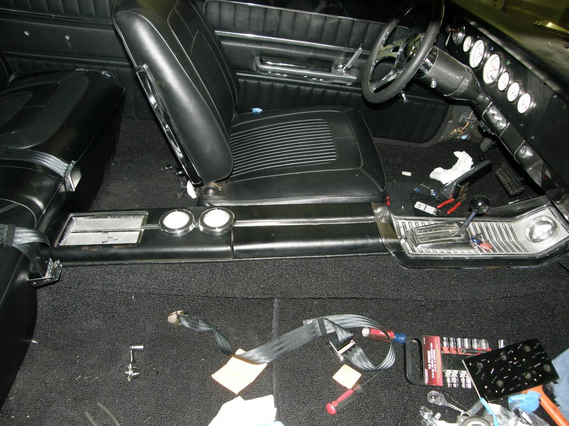

So this is how the longer style console fits, just like I pictured it in my head. I think it makes a world of difference going all the way to the rear seat, maybe a tad more classy than the short style?

Almost forgot, installing the rear seats is a bitch!!! It took me a total of 3 hours to get them in and I used every word in the book and even made a few up. But in the end, they complied to my brute force, I did pay for it with a headache that last until late that night, so who really won? lol!
