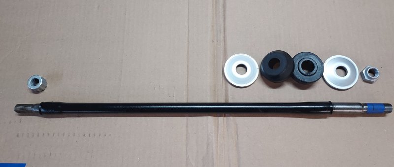

While cleaning and painting my Lca struts I not8ced the ends look deformed. I'd this normal or should I think sbout replacing them. They appear to be after market as they don't have a hole for a cotter key.
If they are bent then replace them.
they do not look bent its more like the ends were pushed into a hollow tube deforming the tube upon entry. but if you roll them on the ground they are just fine.
I think mine look the same.
That's probably just the way they were originally.
I think those oem strut bars are forged. And are stronger than aftermarket parts . As long as the threads are good. I'd use them.
How did I reply into someone elses answer? Weird. Im thinking Im going with the ones I have.. Thanks All
The main load here is only in tension.
Nothing I see concerns me, even if odd.

Also consider, they are often and/or used to be called "brake struts".
Not all of them had the holes for the roll pin.
