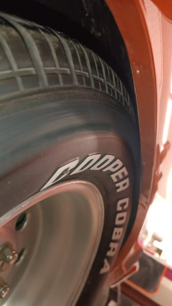

Hi,
I just bought a 69 Satellite and there‘s a little issue with a rubbing tire at the right rear wheelwell (got 275‘s). Will it work when I replace the shackles with a 2 inch longer flat bar? If yes which steel should I use car got a 350hp 318 block
(I can send more pictures the next days car is currently in sweden needs to be shipped to my country)
Thanks!

275/60's will fit your car easily with correct back-spaced wheels. Otherwise, you can buy shackles to lift the rear very cheaply rather than make your own.
We may deal with the tire rubbing issue mostly on the rear driver side. It got new 275/0 bfg's from 4Wheelonline just last week. Gonna order shackles.
