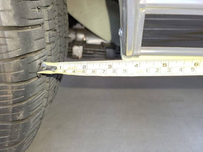

I have over 3 inches from tire to wheel lip.

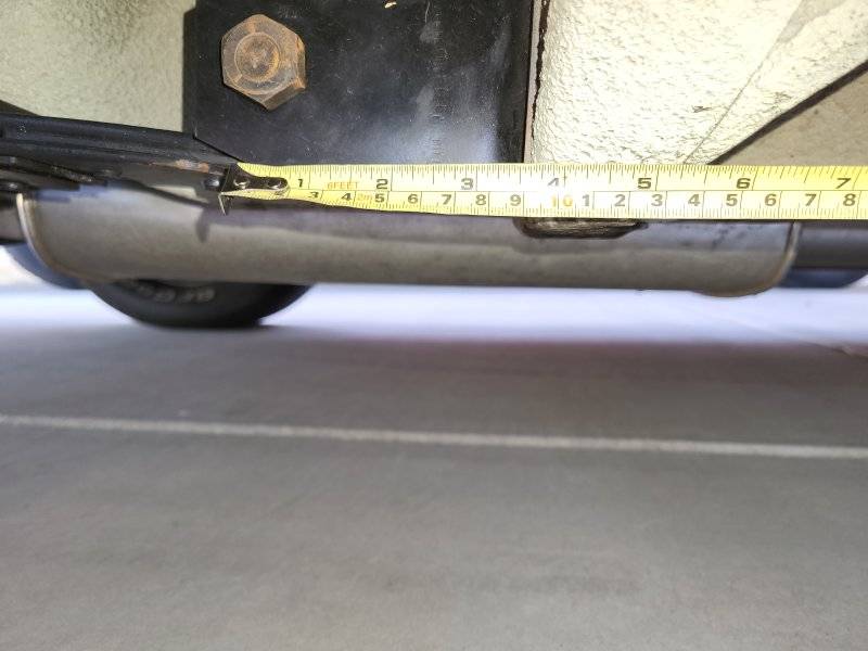

Same measurement from leaf spring center bolt to frame bracket
My other car is just over 2 inches same locations

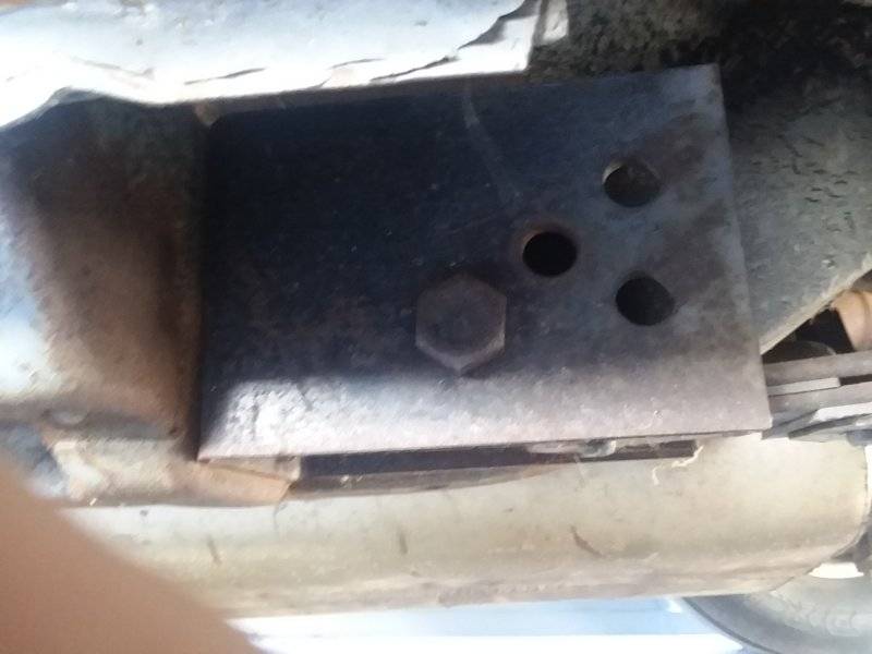

When I bought ss springs for my 62, i bought the "superstock spring hangers" that I supposedly needed.
Turns out, my 62 with the rear moved BACK an Inch didn't need em. So I drilled the hangers where I wanted them. This is how they ended up.
I
I would suggest drilling a hole one inch ahead of the hole there.
Now that Ive seen where they are compared to the other car
Thats my plan. pull them off a just drill new holes
If you have a vibration after you do the new forward holes check if rear trans bushing. If you need the remove/install I can loan it to you.
If the driveshaft spline engagement has been too short and the yoke wobbling, there’s a good chance the bushing has been taking a beating.
I agree with dadsbee, after seeing the pictures it looks like Dodge spring hangers on the front. Makes me question what your shackles and shackle mounts look like. My experience is that the Dodge has the shackle mount hole over an inch further rearward in the frame than the Plymouth. If you have stock length springs moved rearward over an inch how well are the shackles working? Or have those holes been moved?
Without knowing the history of the car, what springs were on it and what's on there now its hard to determine what happened. If someone in the past installed S/S springs, they have a shorter front segment and would have required longer brackets. Then if you installed stock springs without changing the brackets you'd have moved the axle back - which it certainly looks like. A quick indicator would be a very steep angle on the rear hangers - as well as a driveshaft that looks to be too short.
