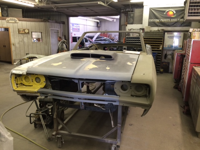

Need help on install of new XHD leaf springs on Coronet. I believe one set has six leafs, other has seven. I know this will seem silly to you guys but I don't know which side the extra leaf goes on, help please? IMG_0863.JPG
i.e., passenger side. The extra leaf is to compensate for when the car launches and it twists to the passenger side. Extra stiffness to counter the torque going that way.
extra leaves go on the right side.
Keep in mind the extra leaf will make the passenger side sit a little higher than the driver's side.
Thanks guys, that's what my gut told me but I figured it best to know for sure. Knew you guys would come through.
