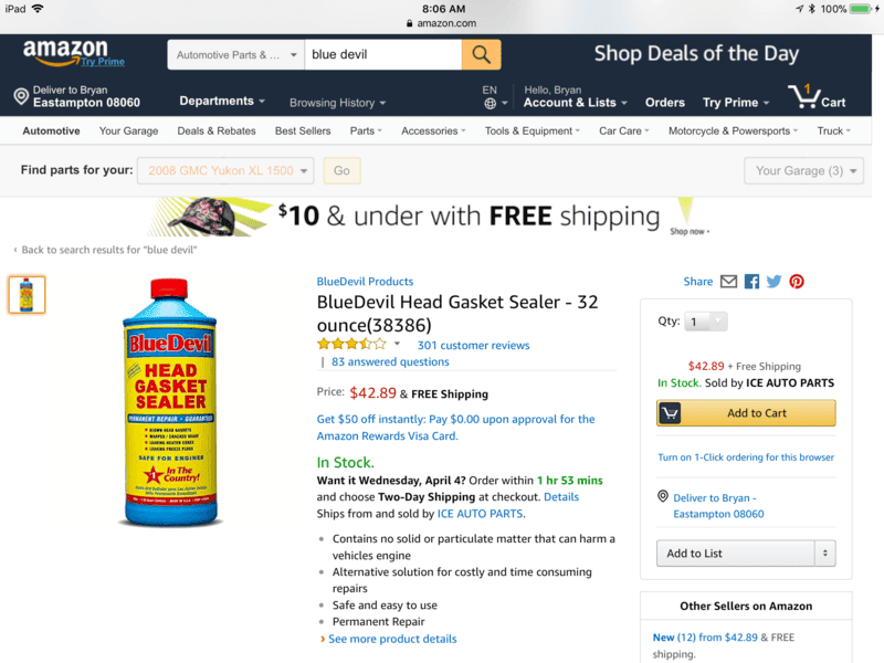

This will fix it without removing the head.
