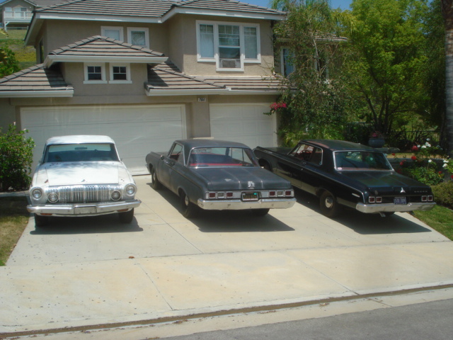

ok i've got 4 early b body dodge 62-65, whats the deal with every one leaking AFT all over the place, never in my life have i ever had a mopar leak so much, when i park on a hill (my driveway) it gets even worse sometimes even my drip pan over flows. i need to fix all 4 cars, can someone point me in the right direction in where to start looking for the leak, it's not the dip stick tube, not the pan gaskets. is it the torque converter seal?
please help?

The old boys use to say if they arent leaking their out of oil.4 nice mopars ,i wouldnt mind haveing your problems.LOL
