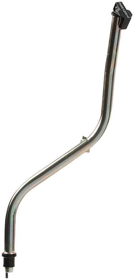

I've used the dipstick linked in post #10, they're great if you don't care about originality. They use a grommet which is far superior.
If you want to keep it original, check your tube for cracks, I've seen more than one tube cracked in the area around the o-ring.
