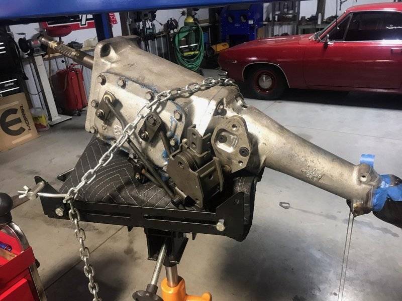

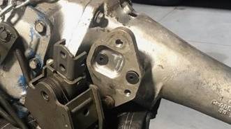

I just got this pic via text:
Two things of note in this pic:
1. That purty Barracuda!
2. The shifter plate is about to fall off the dang transmission.
Damn, I hate relying on others to do this work. Last dude thought that was a properly installed plate....:mad:
You might ask if the plate is tight since it looks like it might not be.....
Did you text him back to ask if it was indeed loose?
Maybe this will help...
He specifically texted that pic to me to see if I'd catch the loose adapter plate.
Of course, I did, right away - once I got done staring at that pretty Barracuda again. :)
I also caught that raggedy bottom bolt being used on the plate, instead of the proper pretty flush screw that should have been there...

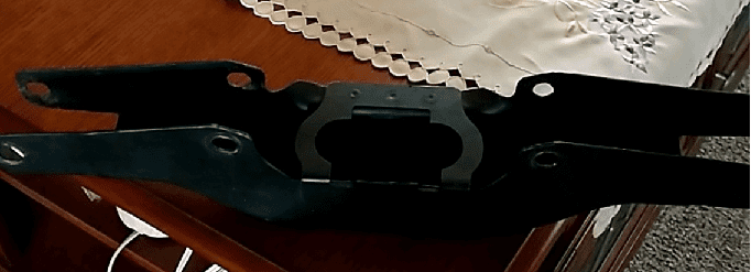

I forgot to bring along the old, original crossmember he needs, since the transmission
going in is a '67 and the one coming out is the special one Brewer's sells for mounting
'70-up into older cars.
Oops.
The Brewer's piece. Reckon it won't be needed now.
Guess I could sell it?

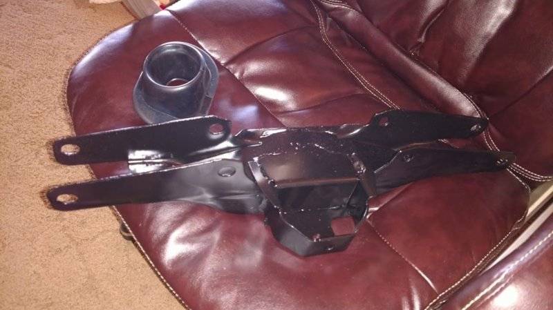

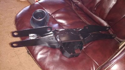

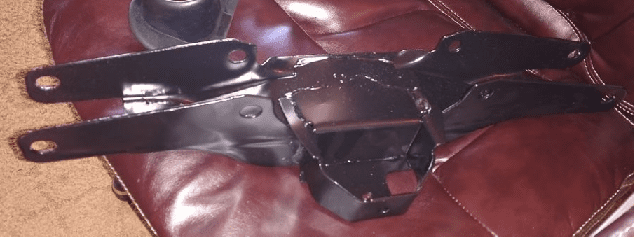

I'll get this one down to him tomorrow so he can wrap things up:
Update again.... *sigh*.
Everything was going great and the bellhousing even indexed within tolerance.
The mechanic got to my cobbled up z-bar and came to a screeching halt. :(
Hey, he's a stickler for doing it right. That's what I want, so no fussing there.
I get Dan Brewer on the phone and holler for help (again).
I tell you what, that man is all I'll ever deal with concerning transmissions and such.
