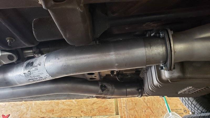

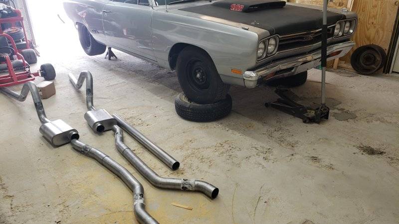

3" exhaust going in today and tomorrow. Dynomax Ultra Flow straight through mufflers. Same system that was on the car, only 3" vs. 2.5"
Looks like a nice exhaust upgrade! Cool car.
