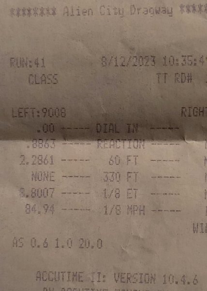

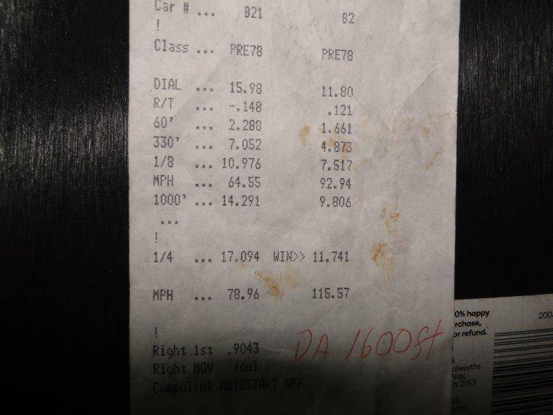

Heads were purchased 2017, not milled. Tires are M/T ET DOT rated street slicks. 275/65R15. 37 degrees total timing. Initial is at 21 degrees. Light springs brings total in around 2200 rpms. Any more timing and it pings on 91 premium gas.Here's what I've gathered. You're at altitude of about 3500ft. The actual compression ratio is between 9.9-1 and 10.3-1 depending on if it's early 84CC or later 80 cc Stealth heads. Or if they've been milled. Either way at higher altitudes, fairly big cam, low compression is taking away power. If it has sticky M/T's it should hook. You don't mention if they are street radials or something else. I don't see 265's in M/T's line up. Car doesn't appear to spin much if at all in the video. First thing you need to do is use the tach. That motor will like close to +/-6000 rpm shift. In the video it wasn't close. Second it needs to hook. It may need better tires to do that. No trailer? Spare set and a floor jack. Or get something for minimal street use. Make sure it's tuned. Decent A/F and timing
(35? total). It would like more gear. The biggest improvement in the motor in my opinion would be more compression. Especailly at your altitude. Until you are at this point anything new parts are not a wise choice. Rocker arms, big headers, etc. I honestly think with proper shift points, tune, and traction it'll get into the mid 12's as is. 4500ft D/A is probably close to 9.5% power killer over dyno air. So we're talking close to 50hp. Compression and gear will help overcome that.
Doug
Those tires should work. Are they radial or bias? Radials start at 19psi. Bias start around 15psi. I'm assuming standard street shocks.Heads were purchased 2017, not milled. Tires are M/T ET DOT rated street slicks. 275/65R15. 37 degrees total timing. Initial is at 21 degrees. Light springs brings total in around 2200 rpms. Any more timing and it pings on 91 premium gas.
Milling heads would be the easiest option. I'm looking for 3.73 gears but I haven't had luck on in stock sets.
Radials. I'll definitely try a lower air pressure. Standard street shocks, Bilstein. I have a sway bar I'll unhook as well.Those tires should work. Are they radial or bias? Radials start at 19psi. Bias start around 15psi. I'm assuming standard street shocks.
Doug
Hmmm. With a combo like yours you would think that you could run better than 17.094I think you have potential to run a lot quicker, you have better flowing heads than I do. I have a similar combo and was running about what you are. I swapped out my street tires and 3.23's for drag radials and a 4.10 gear, went to a 1.6 ratio arm, DA shocks on 4 corners and a little head work myself and had a backcut put on the intake valves.
440/448ci, edelbrock rpm heads and intake, 850 quick fuel, XE282S, 1 7/8" headers, 2.5" exhaust dynomax welded mufflers, 727 11" converter. 4.1:1 gear. 3900lbs all up. Looking at a converter upgrade and open pipes with header extensions in the progression to lower ET's.
