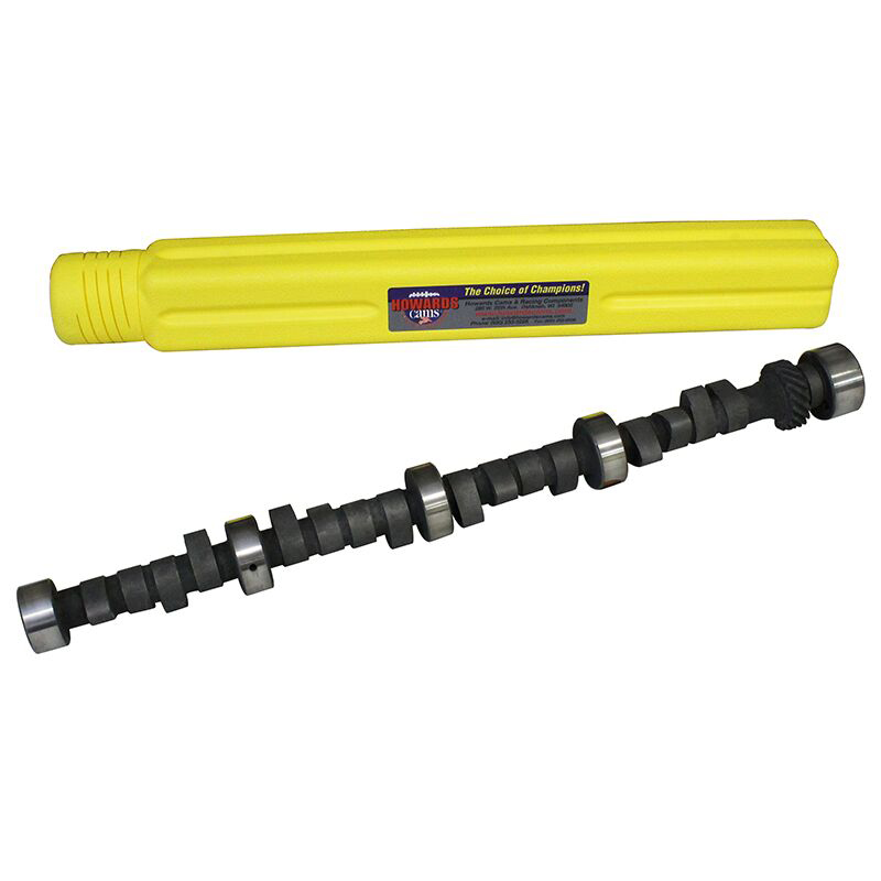

So I have been looking at my combo and thinking about getting a new cam with a bit more duration but was wondering if that is my bottleneck for more power. Not too woried about street manners and would like something a bit more lumpy at idle. I do intend to race a bit at the track in Roswell, which is 3573 elevation.
Here is what I currently have...
440 block, .040" over, stock stroke
Forged crank
KB 237 pistons zero deck
FelPro head gaskets .039" compressed
Stealth Heads, CNC ported (Intake 311cfm @.550 lift / exhaust 210cfm @ .550" lift)
Hughes 1.5 Rocker arms
Holley Sniper EFI 550 (650 max HP)
Holley Street Dominator single plane intake
1 7/8" long tube headers into 2.5" exhaust
Pertronix Ignitor III
Cam - Hughes STL3842BS solid lifter, 105* centerline, Duration at .050" 238* / 242*, Lift .558" I / .564" E
PTC 9.5" torque converter
3.55 rear end ratio on 275/65 R15 tires
Air in, air out right? I like the cam but the engine seems to top out a little over 5700 rpms, which is where the cam power band ends. I was thinking a similar cam with more duration to bump the power up into the 5900 - 6000 rpm range. Car has plenty of power down low as it sits. But am I hitting a road block with the intake or the headers or even the heads?
Best 1/4 and E.T at 3573 elevation was a 13.15 @ 106.81
Looking at the Hughes STL4650BS, centerline 104*, duration at .050" 246* / 250*, Lift .576 I / .588" E. I would be able to keep my springs as the specs are identical as to pressure. And I want to stay with solid lifter. I'm not interested in going roller.
Thanks!

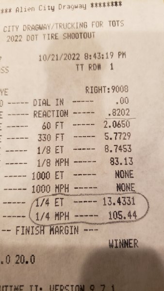

A couple questions. What exactly was the DA when you ran the 13.15 @ 106. Was it the 4400’? What was the 60’? Better yet, can you post the et slip?
For me, step one is confirming that what it runs now is reasonable for the combination of parts that you have. Your parts selection sound like a good combo to me, but is it running the numbers it should?
Your reaction times are a little rough, but have no connection to your et. Try leaving right on the last yellow.View attachment 1471802View attachment 1471803
There is room for improvement at the light so I believe it can run high 12's with good traction and reaction.
No offense. I know I suck. I use the footbrake technique. Try to leave at the last yellow. If I stab it wot the tires spin so I go 3/4 until I get off the line. I need to experiment with my burnout with the MT E/T tires. I take it to about 3k but I have to hold the brake hard to keep it from going.. I think drag slicks are a great idea too.No offense meant (ever notice that whenever someone says that, the next thing they say is offensive? ) but your 60ft is horrible. With your presumed power, converter and gear, I would hope for a 1.75 and expect low 1.8s. Pick up .2 in the 60, that's at least .3 in the eighth, and probably .4 or more in the quarter. Boom, 12.70s.
Slicks would be my step one. Way,WAY before a cam swap.
Edit: and as said above, reaction time has NO bearing on e.t. (or speed). Sit at a green lite for ten seconds with a twelve second car, then make a pass, and you will have a 12 second e.t....... and a 10 1/2 second reaction time.
See above.Have you determined what your actual stall speed is? A PTC 9.5 should be a good piece.
And what is your starting line technique? Stab it from idle, full throttle to stall against the brakes, bring it to 2500 and stab it? It makes a difference, especially with poor starting line traction.

Based on your time slip mph, your corrected hp on that run is estimated at about 480 hp assuming 4000lb race weight. With the parts you listed I would have guessed a little higher hp, but not much. My guess is that you can find another 20 hp in track tuning, maybe more. I think your compression ratio is about 10.0:1. Is that correct?
For a true street tire, your 60' is not that bad. But with practice you should be able to get to a 1.95. Also, try different shift points. The time slip with the 13.4 et had a better 60' than the one with 13.15. That is unusual and suggests something was going on down track on that pass, or maybe the tires broke loose after the 60' mark. Do you know?
I suggest that you get the current package dialed-in before you make changes.
