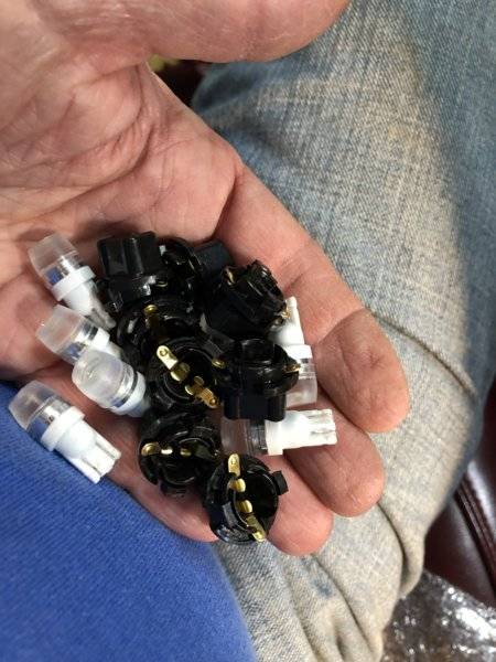

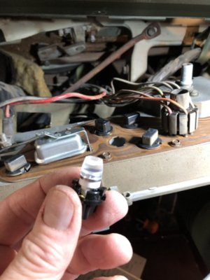

Hey gents, I upgraded all my cluster lighting to LED’s. Much brighter than the old incandescents. All worked well until I mounted the dadh back together. I dont have my ignition light or my right turn indicator anymore. I figure its a ground issue but wondering if anyone has done this conversion with the stock flashers.

614CC084-DE41-442C-9C4D-80741C4DE6FE.jpeg 45D483F2-C64F-4644-BA52-93F2A6F404EB.jpeg

My fuel and temp gauges are out. I installed the solid state voltage limiter regulator but still are both out. I did burnish all the contacts for each bulb socket. The ignition dummy light was working prior to bulb replacement so I thinkbthats a ground issue with the socket.

mopar friend, looks like you are moving right along with your project keep it up. everything you done sounds great you might have to wear sunglasses at night. i hear the led bulbs are pretty bright. as for the ground problem this is a guess did you check your dimmer switch. had one that had a dead spot and cause the dash to go dark or real bright just a thought. good luck
Oh man I know I have weak ir even dead spots in that crusty dimmer! AND I didn’t think to move it about. I will try that tomorrow!
