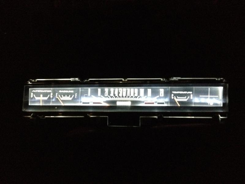

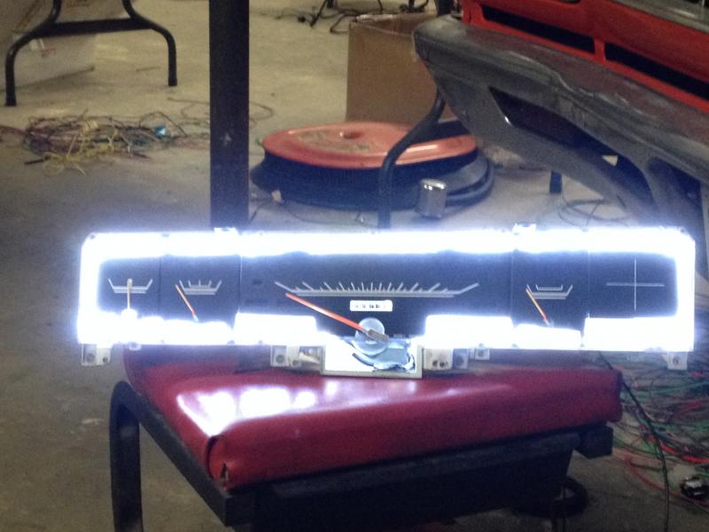

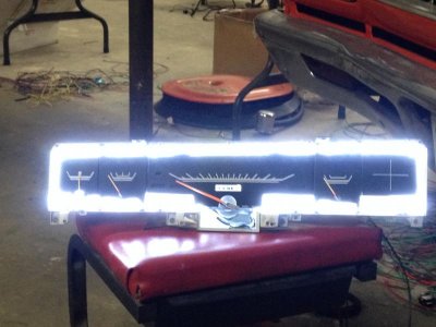

Instead of just getting LED replacement bulbs for the dash lights the guy doing my wiring wanted to try using strip lighting around the perimeter to give a better light. We ordered a 5 metre strip from Classic Industries and used about 1.5 m to give you an idea
Here's some pics of the dash detailed and lit up.
Wow that's bright! are you able to dim still?
That was just lit up bench tested. The plan is to still be able to dim it.... one way or another if that means swapping out to a different dimmer style as I believe I saw in one of Propwash's earlier posts.
Damn, that could cause sun burn, lol! Looks nice!
Wow you could see that from space, I've seen dimmer headlights.
Nice job.
That does look cool can you get it in blue?
You can definitely order the rope lighting in different colours I know for sure blue is one of them. I'm pretty sure there is also an available style with a controller where you can change colours or actually set it to rotate through colours.
I just wanted mine to be nice and bright... Looks like that was achieved!! lol

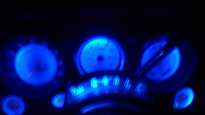

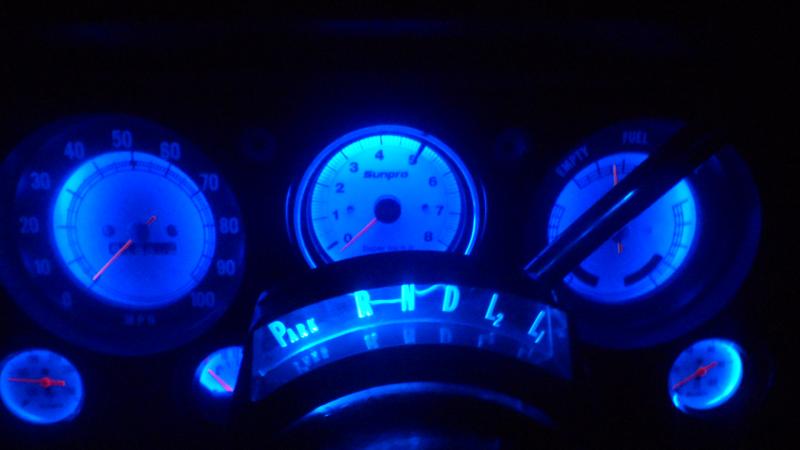

These are like the lights I got for my dash. Blue, or any colour you could desire plus different brightness settings, all by remote control. If you get tired of blue, you could pick amber or white or anything else.
http://www.ebay.ca/itm/2M-3M-5M-LED...09?pt=US_Light_Bulbs&var=&hash=item4d0df40aa5
http://www.ebay.ca/itm/Non-Waterpro...488726?pt=US_Car_Lighting&hash=item1c29b01096

That is a killer idea! Looks good. It will definately look good dimmed down a little.
