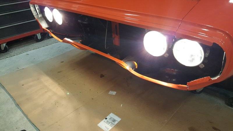

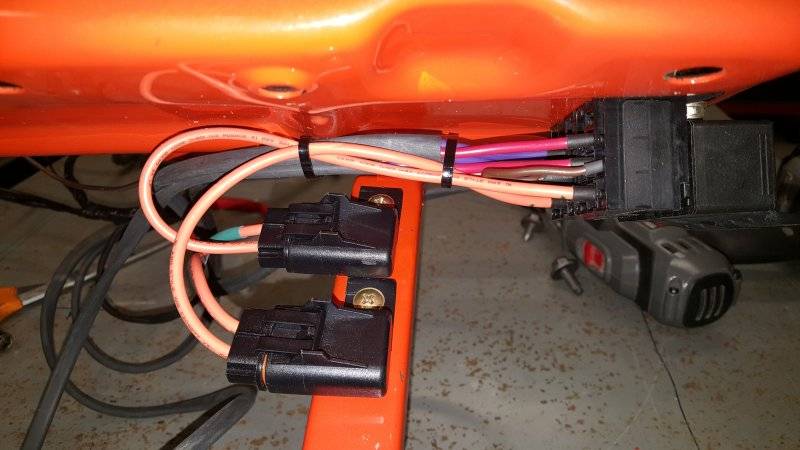

Get a hold of a member "crackedback" to get his wiring harness for 2 or 4 headlights. Also, look at his "wire around". They come with all you need, even relays. Attached is my headlights on just battery, not running and I mounted the relays under my battery tray, on the arm and hidden
