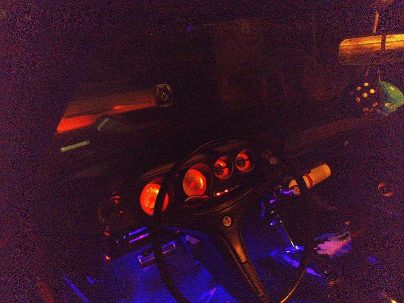

Red

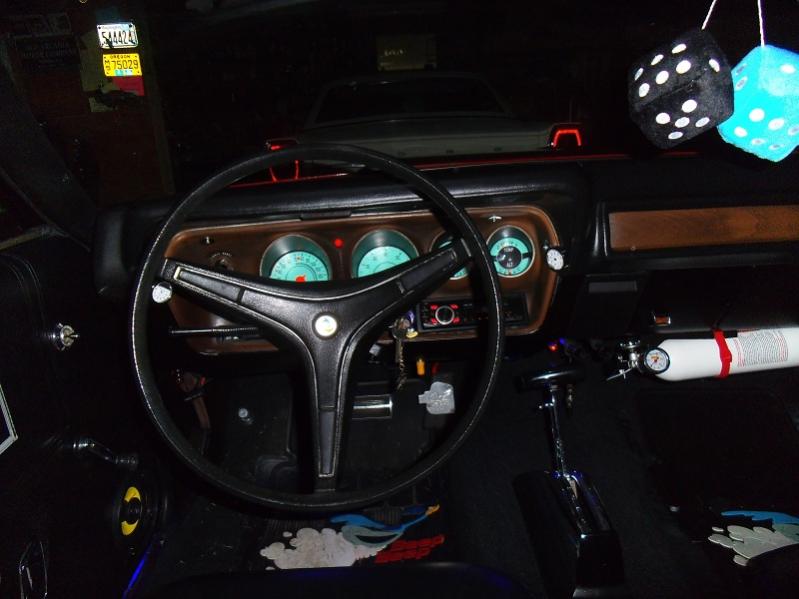

I did my LEDS in red...also Ron 73 gave me some good advice about new overlays so I did them in mint green...Marla

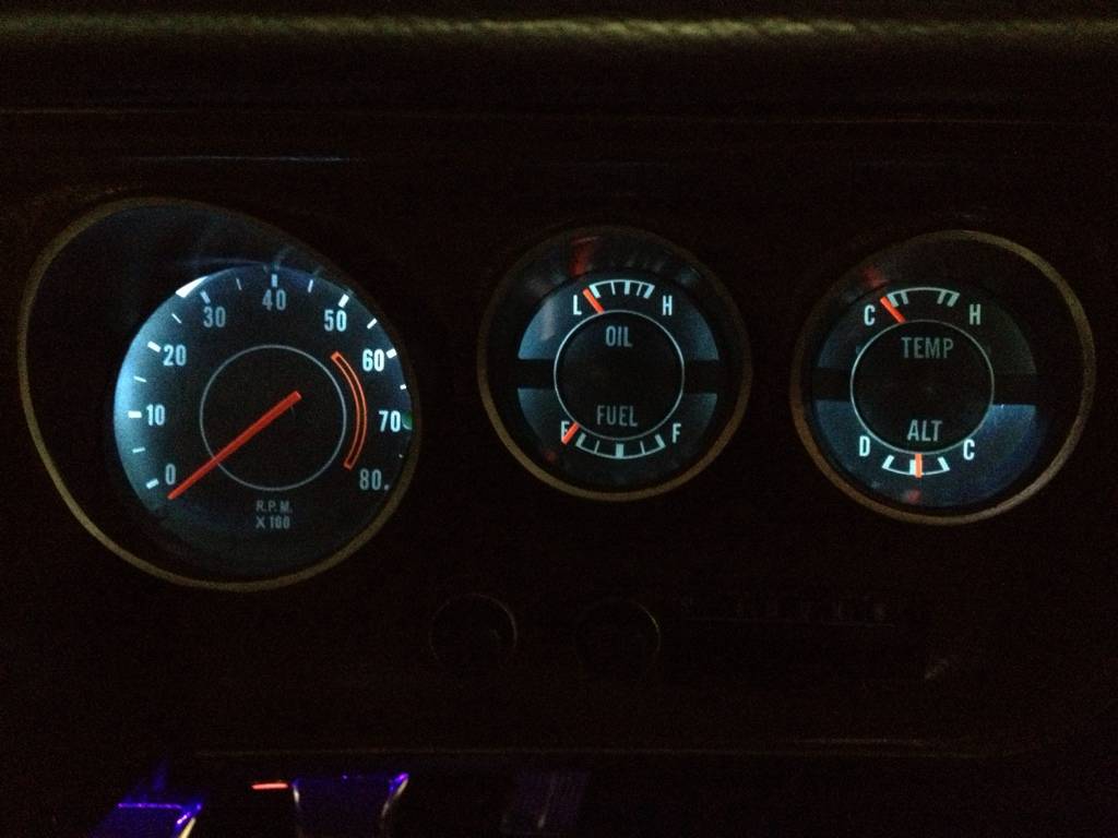

I put a set of led bulb into the my rallye gauge cluster yesterday and WOW! Best $15 I ever put into that car. The LEDs give the gauges a nice white/blue tint and they're at least twice as bright as they were before. For a quick mod, it's well worth it.
Even I am huge fan of these led lights. They save considerable power and not expensive at all
Ok I finally put led's in the dash, looks exactly like moparstuarts pic above ( no pics because my wife took the camera to Italy for Nonas birthday),
it's considerably brighter and easy to see now but not crazy about the blueish color (like the factory greenish better) also removed the dimmer switch and cleaned it, I was surprised how black the contacts where that switch was new when I installed it 20 years ago, that's probably where most if not all of the problem was.
It will stay with led's for now.

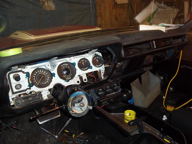

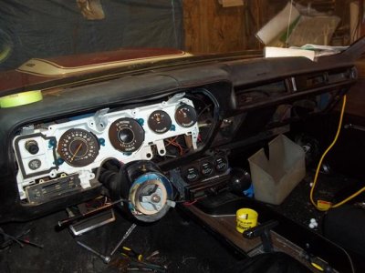

Realize this is an old thread but I did some digging and thanks to some help from Bruce and wookie316, talked to the guy that did wookie's cluster and he said he left the blue filters in place and used a single 1-watt led replacement for each bulb.
Seems like everyone has the same concern that without the filters the LED'S could hurt your vision trying to drive at night, and by the looks of how great wookie's cluster came out, the LED's with filters still in place are plenty bright.
I'll post some pictures in this thread when my cluster is done, and for anyone thinking about doing the coversion I hope this post helps :icon_thumleft:
