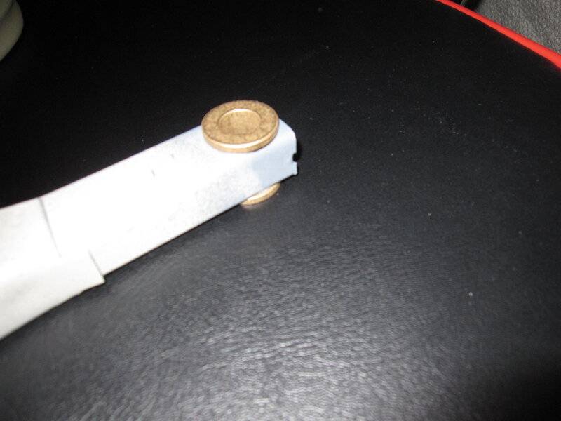

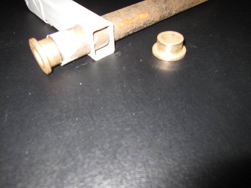

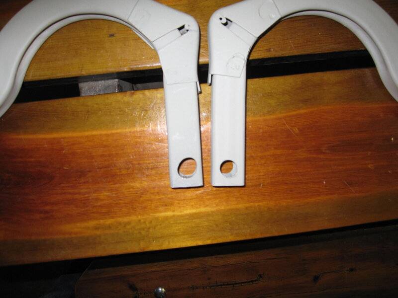

I haven't got into a newer B so I can't say for sure but the older Bs had a piss poor hinge design and would wear oval which screws with deck lid adjustment. Look at the attached photos for my correction.
