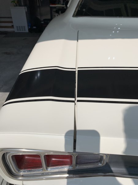

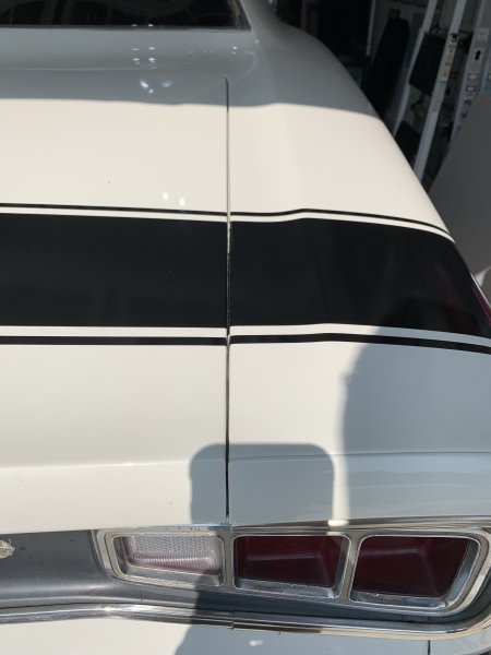

Hi All,

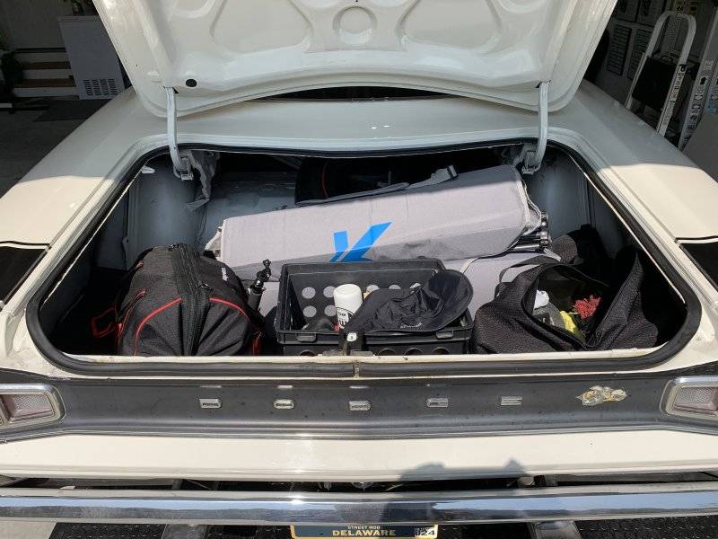

When I got caught in the monsoon coming back from Carlisle, there was standing water in the trunk.
I have an approx. 0.3" gap between the trunk lid and the fender on the left side and 0.1" on the right side. I also have approx. 0.1" difference between the bottom of the trunk lid and the top of the fender on the left side. Right side is flush. See pics.
A few questions:
1) Can I simply loosen the bolts for the trunk lid and the mount and slightly lower the left side? This will get it flush.

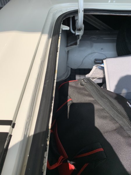

2) Is there something I can put on the weatherstripping around the trunck so that when I close it, I can easily see where the trunk is touching hte weatherstripping or not?
3) How do you move the entire trunk lid side-to-side? If I move it 0.1" from right to left, that will even up the gaps all the way around.
Thanks in advance!!!
Bob

loosen the bolts that hold the "striker"..... the thing inside on the verticle brace inside the tail panel.......looks like you need to raise the latch and move the striker a little left
striker will give you left to right, the latch on the lid gives you up and down........do one at a time
there should be little rubber stops to limit how low the trunk lid can sit, you want to be sitting on both of them, but not too tight......just enough so the lid wont rattle

if it's high at the front corner........ yes, but only loosen one at a time, probably only the front bolt (circled)....... it will allow you to pull the lid down a bit
if the front bolt is all the way down, do the opposite to the other bolt
Weather stripping looks like it's in good shape. Minor thing is the gap where they meet over the latch. Heavy rain and wind action might bring some seepage there but likely not as much as you're describing. You could try a coat of Vaseline on the strip and see of you find areas on the lid with none a that on it...

As far as testing the seal, anything I can put on the weatherstripping to see where the trunk lid does/does not meet the weatherstripping?
At night in the dark, someone shines a bright light on the trunk while you're inside. Or, they can hold a water hose along the trunk from top to bottom, and you can see where it drips inside.

Other possible, check the weather stripping adhesion. All glued down where you can lift it with your fingers? Had that hassle. Adhesive ages and loses adhesion. In the rain a ton of water flows down the channels and if the stripping isn't adhering a point of entry for H2O..
