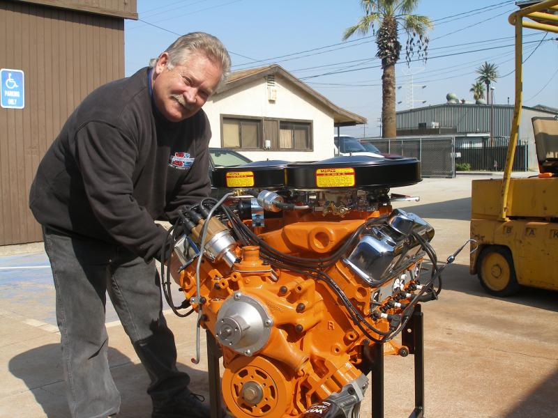

I am lucky enough to have a Dale Reed built 440 as a Max Wedge.
He told me quite frankly on a Friday afternoon, November 2008, the 440 would make me happier.
Thank you my good friend Mr. Dale Reed.
"Dale's Place", Baldwin Park, CA
