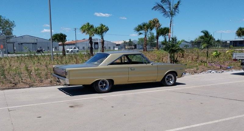

My 67 Satellite,I’ve known this car since the day it was purchased,it was a 383 car now a built 440 and gathering parts for a 4 speed conversion it match my old gtx…
So is mine, YY1,thanks Bill! I catch myself just staring at it, lol
believe me, I can relate to this comment easily.
Ive had days I just grab a cold drink and park my butt in the garage and stare in wonder I own the car I do

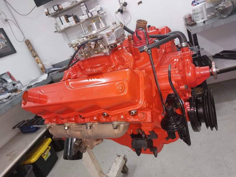

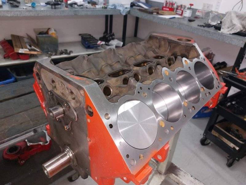

Had to get out for another run with the new 354 poly stroker. Engine is so smooth when cruising but goes hard now, much more torque than when it was a 318.
Went to the city, 92 degrees but gauge didn't go over 195, even stuck in freeway traffic.
Beautiful car, always had a soft spot for 66-67 Satellites as a Citron Gold 66 was my first car.
@66 Sat
Was that a stroker kit?
What else did you do to it?
@66 Sat
Not a kit but all individual parts: Scat forged 3.58" crank, Scat I beam rods, Ross forged pistons, bigger valves (1.94 / 1.60) from Rev Valves. Already had a cam, 4 barrel manifold and 600 Holley so they were all re-used. Just need some headers to let it breathe, currently running the factory manifolds.

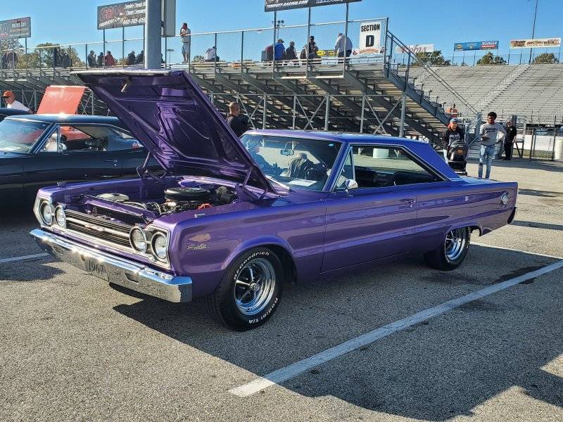

Been a while since I have posted. Here is picture from Maryland International Raceway last weekend. Lots of projects planned for this winter, so I will have to try to post as I get things done.
