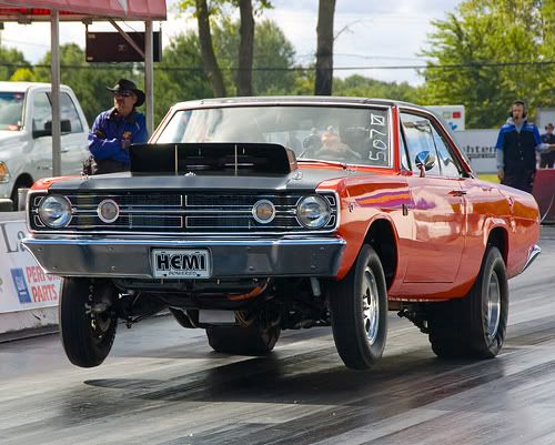

I use the Calvert 90/10 shocks on the front. I drive it on the street, even some twisty mountain roads on the way to the track and they work fine for me on the street and on the strip. My car runs 7.90s in the 1/8 so it's probably about the same as mid to low 12s. launch_zpsd8cbe585.jpg

I agree in this video the front shocks are wrong. This is a classic example of front shocks that are to loose. The front end tops out, then unloads the rear. These are 3 way. Where were they set? On full loose? Like Chris says, this car may not have enough suspension travel. We don't know because the shock is so loose the rest of the car isn't working at all. This could be from the shock being to short or the suspension hitting the limiter. The shock being to short is an easy fix. Add a shock extension. The shock should not be the travel limiter. This fix could be a simple as adding a shock extension and tightening the front shock. I would definitely try that first.
