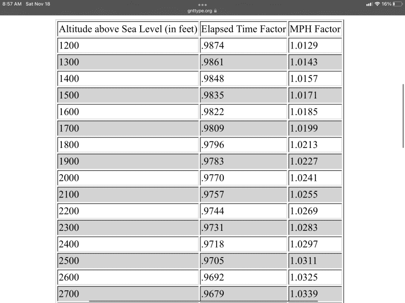

Keep in mind that is Tucson is an altitude adjust track with the elevation of 2490 ft. so 11.50 is more like 11.15. Of course I can’t find the NHRA page on this so I figured it another way.

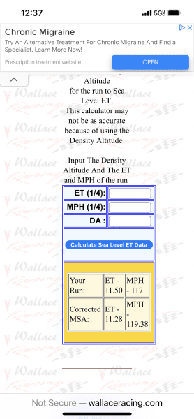

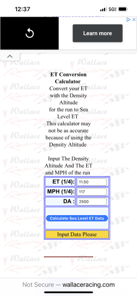

I think 2500ft would be more like 2 tenths...
Biggest thing I see hurting a 11.50 pass is the gear ratio... 4.10's with a 29 inch tall tire would be the best for racing and street driving...
I would guess you need some track runs to get a baseline. Buy some drag radials and run it. Until you know how it behaves on the track I wouldn't change anything.
Well ok then LOL. the math doesn’t lie
Take 11.50 X .970 and you tell me.
Hey you figure it out and satisfy yourself, just trying to tell ya that altitude is a real thing out west, you flat landers don’t deal with it.

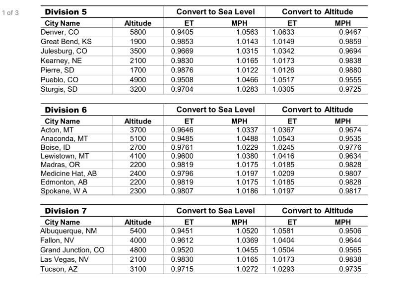

Tuscon had a NHRA division race in 2020.
D/S is an 11.50 sea level index, and at Tucson the index is now 11.82. Hows your 2 theths holding up? LOL.
Click this link and go to #34 qualifier.
LODRS 7-1 - Stock Eliminator Qualifying, Saturday Final Order
I understand altitude just fine. You do realize other weather factors are at play so throw barometric pressure, temperature and humidity out the window…. My 2 “thenths” holding up just fine…Lol
I brought this up so the man will understand that 11.50 isn’t 11.50 at Tucson. Just being there makes it slower, before you figure your weather.

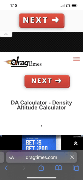

Density altitude is a lot different than running at 2500 ft. elevation. Try it and then you will believe it.

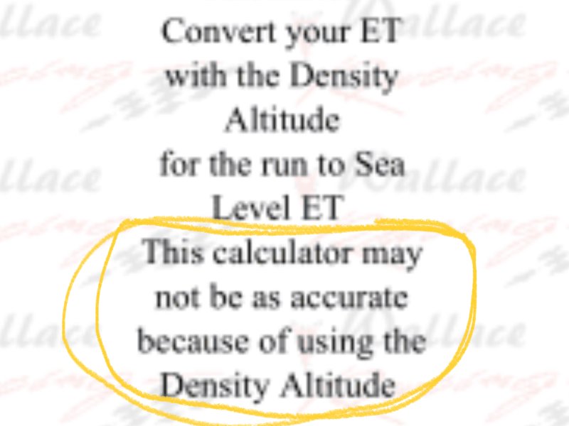

Ps your calculator tells you density altitude is not as accurate! LOL
Cause of other weather factors like I mentioned… at least they are honest. Cecil County is 400 or 500ft above sea level if I remember that said how did I and others make passes at below sea level? Krouse construction owns it so I guess they excavated the track down to that level for that day. It’s corrected differently everyday. It’s why you had to go back 3 years to fit your narrative.. I understand what you are saying it’s just not as much as you think due to other variables and I will leave it at that… if he runs an 11.70 there it would be about an 11.50 at a track close to sea level ALL conditions the same..
This isn’t helping the OP until He runs his car and gets the data needed anyway so I am done. Feel Free to PM me if you want to talk more.

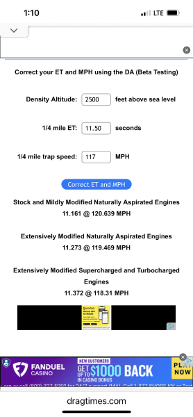

This one from drag times shows a variable of a tenth to 3.5…

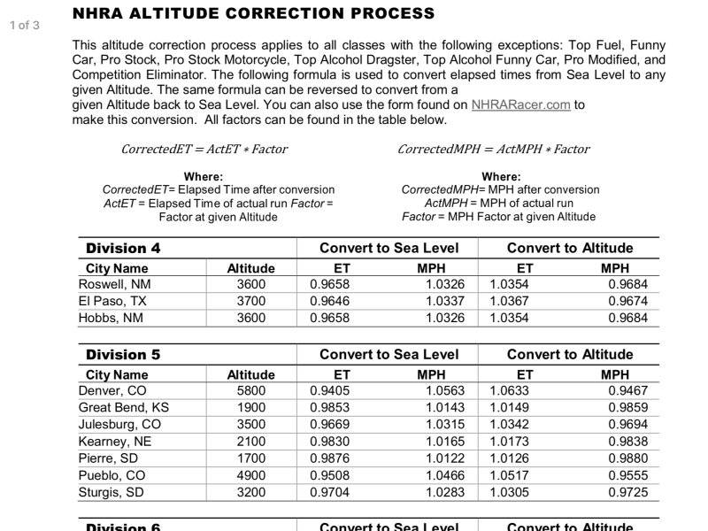

For anyone interested in NHRA altutie correction factors, here is their page. It’s a constant hard number, not subject to change. 2020 was the last time Tucson had a NHRA division race, so I used the most recent numbers.
Please notice there are no altitude adjusted tracks east of El Paso Tx. Thus the confusion of some folks as to what this really means.
https://www.nhra.net/2014/images/nhraracer/altitudeCorrectionProcess.pdf
