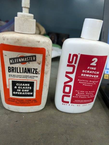

Other than the softest Terry cloth towels recommended for the job, which brand of cleaner and polish is best for Lexan glass maintenance?
I used Plexus and a virgin (never used) microfiber towel for cleaning. Polishing is different. Look in aviation catalogs for that. Tend is one brand. There are several grades. Don't get the most abrasive. It's has way too much grit for us.

Novus (I think that's how it's spelled) was another brand of Lexan cleaner

Here are some options. These work very good.
