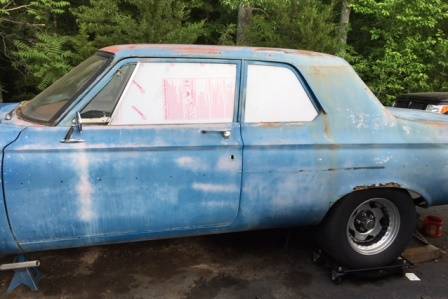

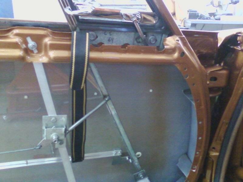

OK, I have a 65 Belvedere I, 2 door post car. It is basically a race car. I have recently taken the window glass out and replaced it with Lexan. The rear windows are permanently up, which is fine as there is no back seat. I want the door 'glass' to roll up and down without using the factory regulators. I was thinking of using something like the factory did in 65, seat belt straps. The problem is, the shape of the window doesn't let it follow the tracks and the window easily goes off track. For now, the door 'glass' is permanently up. I was just wondering if anyone has solved this problem, specifically on a 65 Belvedere Post car.

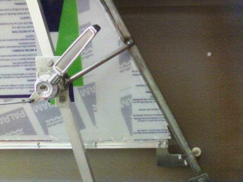

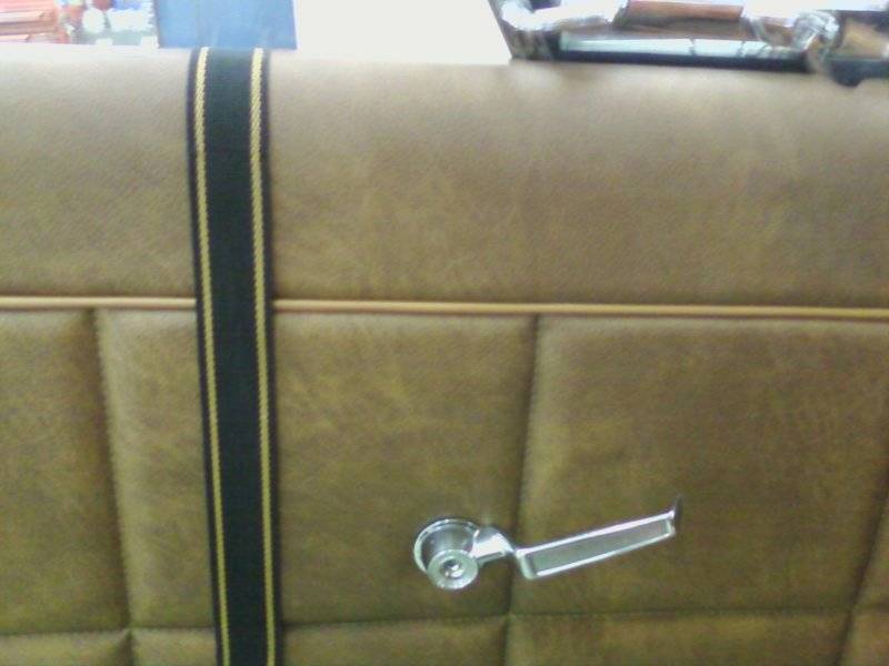

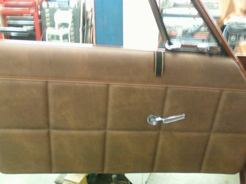

Here ya go. As you pull the window up the strap will move rearward. Place snaps in the panel acordingly.

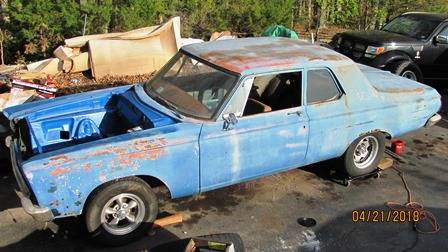

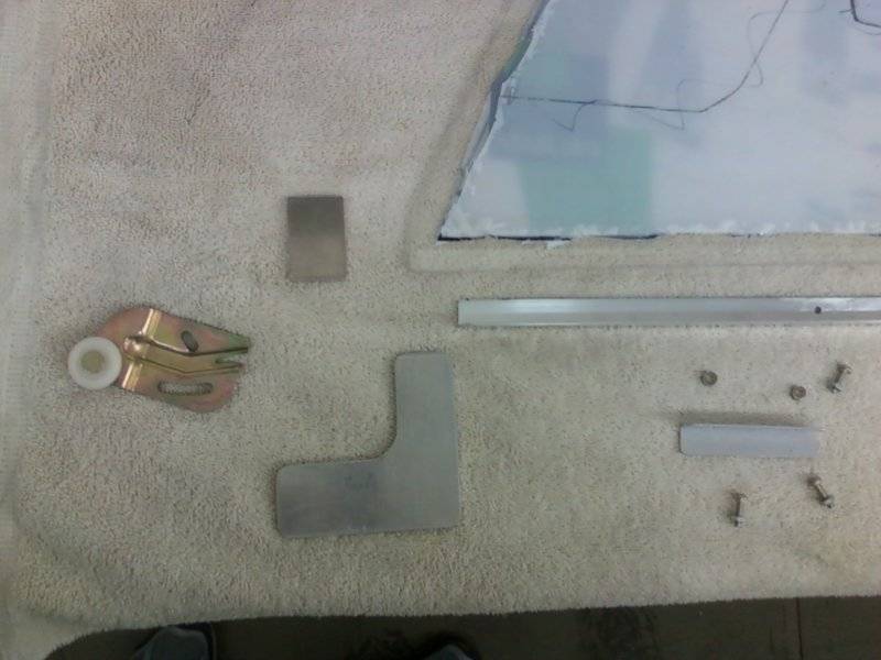

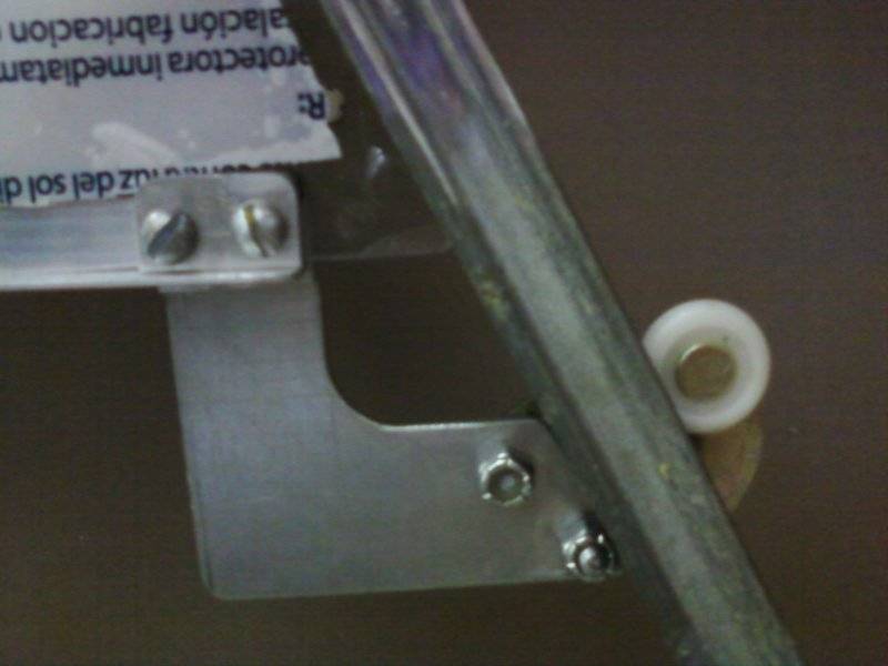

Matt, does a 64 tudor post count?? I am going to put lexan windows in my old plymouth, I am going to do it two lane blacktop style with a slider. back half of the window will be permanetly in place and the front half will slide back, small knob and a screen door hook will do it very simply. I am having bent a piece of 12 guage alum. bent for the bottom runner, 3x1x.5 wide. 36 inches long,(will trim to lenth). KISS princaple. Dave.
I am going to give Doug's method a try. If I can't make that work, then I will go with Dave's solution. I hadn't thought of the half sliding window. Definitely better than a permanently 'up' window.

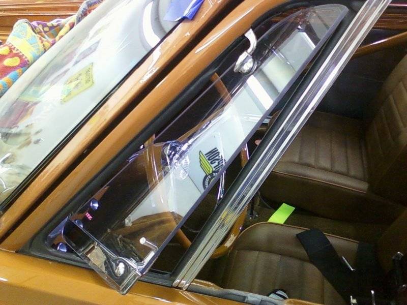

Not that hard. Do make the new window longer than the original. Trim as needed afterward. Peel the paper back only slightly when sanding the edges to prevent scratches. 150 grit will look like factory glass. Don't forget the vents.

i stole dougs idea for my 64 330. it was easy and works well. the only thing i did different was add a stop at the bottom of the door so the glass cant go below the top edge of the door. sorry no pictures.

i made mine. i recommend using polycarbonate instead of lexan or a uv stable lexan. most lexan is not uv stable and does funky stuff in the sun. i used the factory glass as the pattern. used a jigsaw to cut them out a little oversize then sanded them to match. i also put extra masking tape where the saw would touch the window to protect it. it takes a little time to do but well worth the weight savings.
