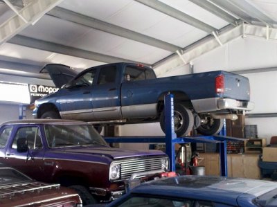

Here is my 2005 ram 3500 on the lift.

Good points for the heavier trucks 451...as you say the options are what add up, depending on your needs...for example, when I bought mine they included the truck adapters, to allow for higher frame heights (2 post lift).
That's a great lookin' shop you have there!!

Thats actually my friends shop. Right now I don't have a place with the celing height for the lift.

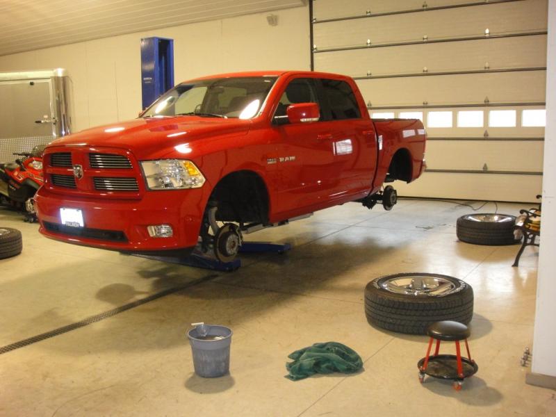

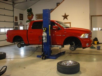

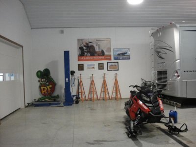

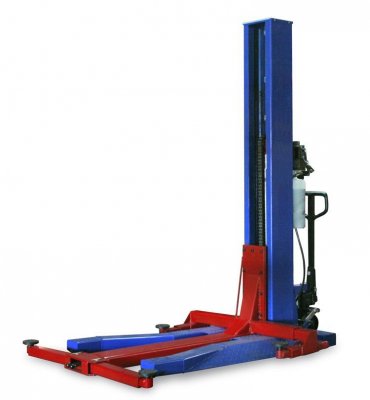

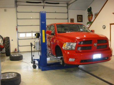

I bought a portable lift that is like a pallet set of forks. Not as stable as a 2 post stationary, but is mobile so I can store it out of my way. Also I can move it around anywhere on the concrete and lift a vehicle without having to shuffle. No drilling into the floor either.
I bought a set of tall jack stands (called transmission jacks) which I put under each corner as safety measures when I have a car or truck up for extended time frame. It cost about $3000 and was made in China. It went together easy and has worked well. There was a US MFG that made a similar unit, but they discontinued it.
Here are the specs:
MSC-6K Lift
Mobile lift uses "pallet jack" style hydraulics to raise lift onto wheels
Rolls right under vehicle or use the unique drive over design to easily position lifting points.
Thick 13" x 10" column
Chain over design uses a 3"x36" cylinder and 846 leaf chain.
Single point lock release.
Powder coat paint finish.
Specifications:
Model Number MSC-6K
Capacity 6,000 lbs
Power Pack 110vac
Lifting height 72"
Low height 5"
Pad height 5"- 9.5" (spin-up style)
Height overall 102"
Width overall 59"
Distance between lifting pads,column side to offside
60" max 54" min.
Distance between lifting pads,offside
81" max 54" min.

Ma Snart

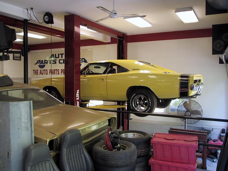

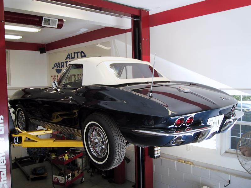

When I was planning my new shop building , I realized that I could have one bay 15ft wide with a 14ft ceiling. I knew then that I wanted to utilize all of the height that I could. I installed a Challenger 9000lb asymmetric two post lift with a two foot extension. Also, quality lifts are only rated at a percentage of what they can actually lift. I have had 10,500 lb vehicles on mine with no problems. I can lift a conversion van or even an ambulance and still walk under the lift arms, and I,m 6'1. I use mine quite a bit , and its been in service now for over 10yrs. Wouldn't turn a wrench without it. I'm too old to lay around on the ground any more. LOL
Those particular wheels on your Charger look outstanding. Maybe the color but look like they were made for it!
Ron, I'm sure you would recognize those as the old Keystone Classics , old school wheels. Car belongs to a friend of mine. I rebuilt the drivetrain for him a few years ago.
"Ron, I'm sure you would recognize those as the old Keystone Classics , old school wheels. Car belongs to a friend of mine. I rebuilt the drivetrain for him a few years ago."
Yes sir, I knew what they are, and they do look good.. My apology to racer-x, couldn't help but mentioning how well they looked on it. Good luck with your lift, they are handy to have.. My brother in law put one in his shop, doesn't seem to be as high as compared to some, i imagine the higher the better, if it can be.. Being able to roll it out of your way sounds good, He, ( brother in law) keeps a car on his and another under it unless he needs it.. which frees up space elsewhere...
