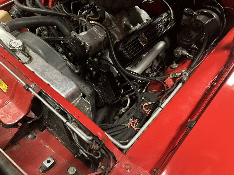

I’m helping out a friend with his car and had to remove the battery for room to install a power steering cooler.

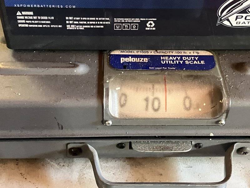

I was shocked when I picked it up.
Seven pounds??
I think I’ve eaten sandwiches that weighed more.
I had no idea these were this light. It feels like a display battery from a repair shop.

As stuff like this comes along, I often wait for it to get cheaper. That battery was $450!
Four times the cost of a standard lead-acid battery. If it lasts twice as long, that would soften the sting of the price.

My battery is in the trunk but because of that, I have the added weight of a 1/0 cable running from the back to the front.
I do like how open the engine bay is without a battery there.
I’m not sure what a stock battery weighs… 40 lbs? If so, this lithium one saves 33 lbs. add that to the longer cables and wires I have and this could be 55-60 lbs lighter overall.
I wonder if there is a more compact lithium battery that could be fitted to a smaller battery tray under hood. One could make a tray to fit the smaller battery. This would save overall weight and Not be such an obstacle in the engine bay.
You could make a tray that sits on the frame rail for that small battery.

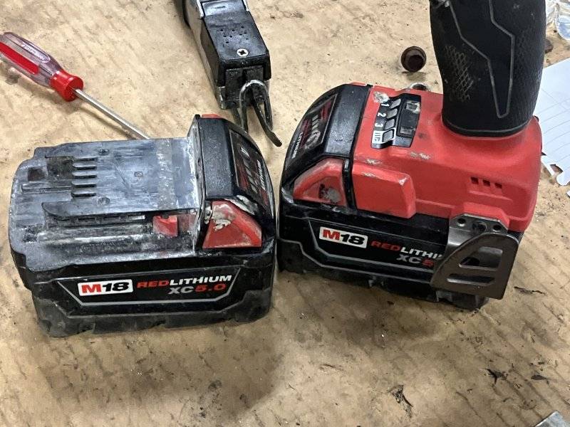

I understand the concern. Nobody wants the risk of a fire. I’ve seen a lithium battery flame out at work. I punctured one with my nail gun. (Accidentally)
It flamed up with a range of colors and intensity. It fizzled out in 20 seconds. That was with a battery bigger than these:

My nephew lost a truck as they think an impact driver accidentally turned on and spun up in a sweatshirt.
