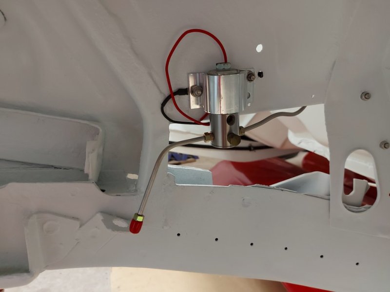

I bought a B&M line lock for my 69 GTX. From my master cylinder I have 2 lines out, both go to distribution block. From the distribution block, two lines exit to frt right and frt left brakes, third line exits to rear brakes.
I thought this should be mounted after the distribution block but I can't because the front lines aren't tied together.
How has everyone else installed theirs?

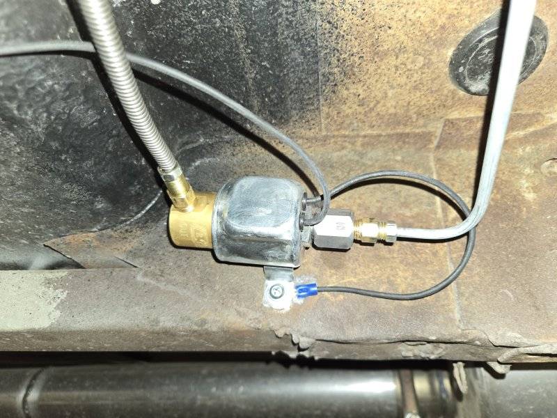

I have mine mounted in the drivers side wheel well.

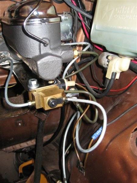

It is plumbed after the proportioning valve.
It's mounted on the other side of the valve hidden away.

I’ve got a Hurst line lock too, but not yet installed. As I understand it, you block off one of the front brake lines coming out of the distribution block. Run the single front brake line into the line lock. Coming out of the line lock, you install a “T” that lead to both front brakes
That is an interesting idea. I'm not sure I have the room down there to cut and flare lines with the engine in place....
This was on my A body, but same idea. I bought a bracket for a Chevy distribution block. In this case I mounted both the distribution block and line lock on the same bracket.

I did the same on my GTX, mounted on a plate riveted to the inside of the frame rail. The plate also holds a Wilwood adjustable proportioning valve.
I have mine mounted to the firewall under the master cylinder mounted by a custom made bracket that I made that is retained by the lower two master cylinder nuts so that it is not really all that visible.
