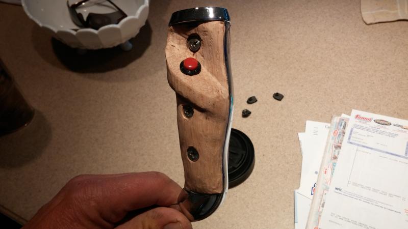

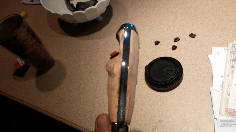

This is my first prototype. Although it is a bit rough, after a little more sanding and the right stain, it'll do the trick. 0427150959.jpg
No, it won't be an issue at all. In fact, you can't really feel the switch under your thumb. I am drilling a small hole in the very base of the shifter handle to run the wires.
Very cool! Nicely done can't wait to see a smokey burnout pic!
I can't wait to take some to post! �� It was very inexpensive to make, 1.50 for a piece of oak, 3.50 for the switch, 8.50 for a roll of chrome tape and some very thin speaker wire l already had. The rest was just a little time with the die grinder, grinding wheel, dremel and drill press. I do have to find just the right color stain.
