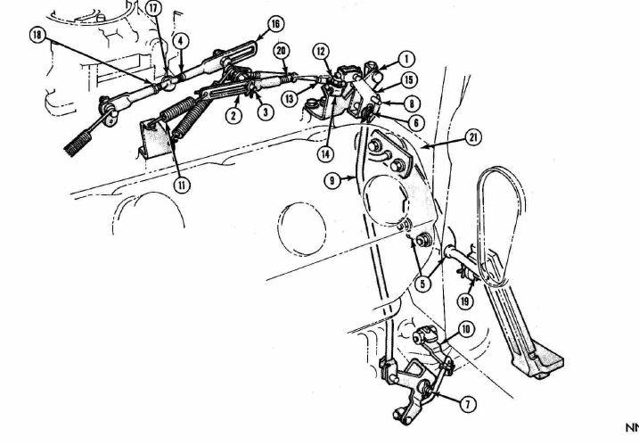

Good Morning,
I have a 66 Charger with Hemi with back to back dual fours.. I am looking for an expert mechanic who knows the 727 and linkage setup for the Hemi. Any help will be appreciated. I live in Central New Jersey.
Thx Vic
Here's a picture, are you missing parts?
Do you have stock return springs? The service manual explains how to adjust kickdown (throttle pressure control really) linkage. Download a service manual from this website, if you have a printer all the better. Believe it's in section 21 trans section. Make linkage it's binding someplace.
