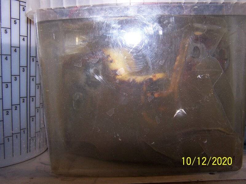

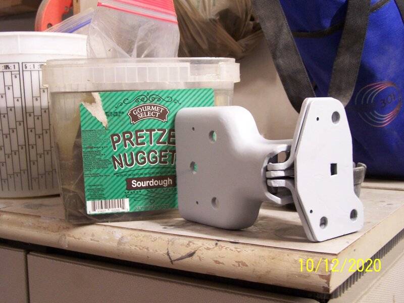

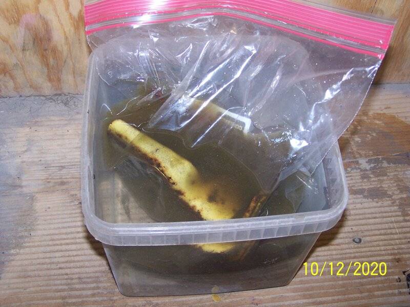

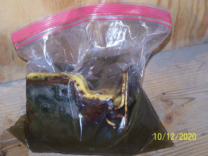

So I needed to soak this part in evapo-rust but I did not have enough to fill the container. Okay, not this exact part but the one from the other side.
So I put the part in a zip lock baggie and poured in some evapo-rust then I put the baggie into the plastic container. It does not have to cover the part as this trick will take care of that.
Once in the container I added water. The water forces the evapo-rust to "squeeze" around the part raising the level in the baggie to cover the part. Keep adding water to the container until the part is covered.
That is it, and it only took about 2 cups of evapo-rust. Just remember to leave a corner of the baggie open to allow displaced air to escape or squeeze out most of the air before sealing the baggie.
View attachment 1013556 View attachment 1013557
