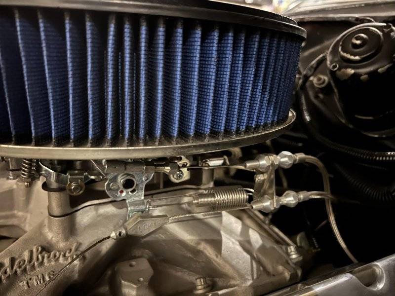

I use a Lokar kickdown cable and what appears to be the stock throttle cable. I have an adjustable bracket that accommodates the throttle and kickdown. I purchased it on eBay from Richard Ehrenberg, works decently.

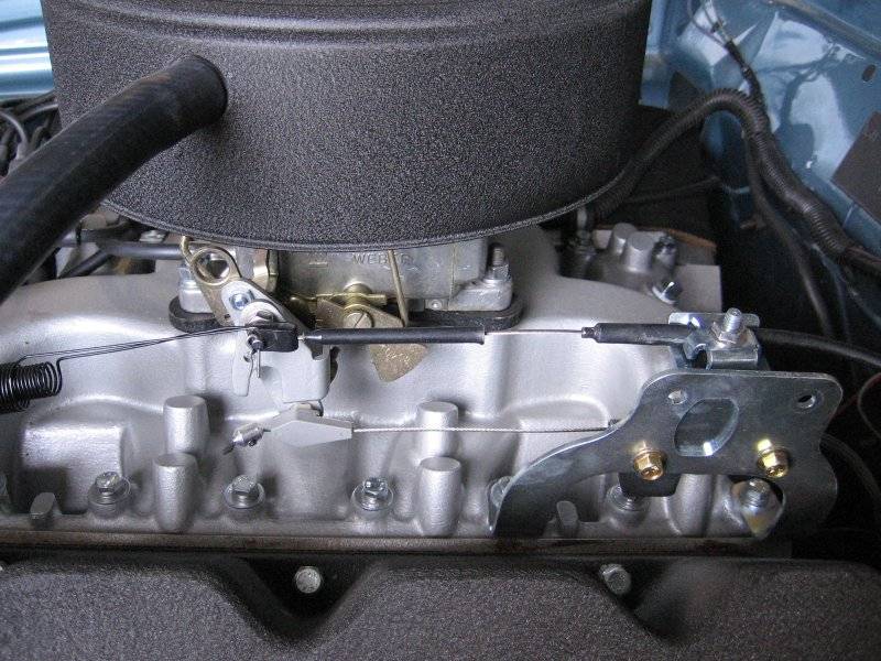

Stock throttle cable with Mancini's (Lokar clone) kickdown and aftermarket throttle bracket that is adjustable.
Bracket maybe Mancini's too,can't remember.

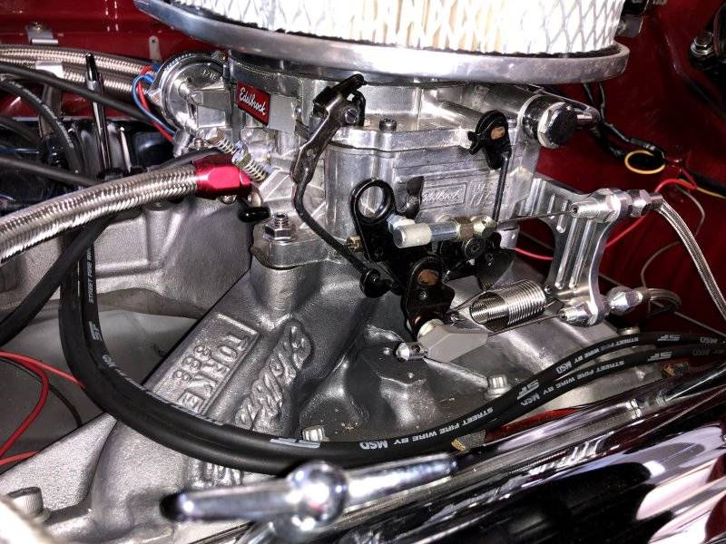

I just installed the Lokar cable kickdown on my Charger with the original throttle cable bracket and an eddie carb, I had to do a little fabricating to the Lokar bracket to get the kickdown cable to the lower outside bracket on the carb. Simple, easy to adjust and works perfect.

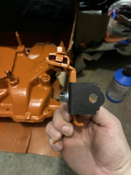

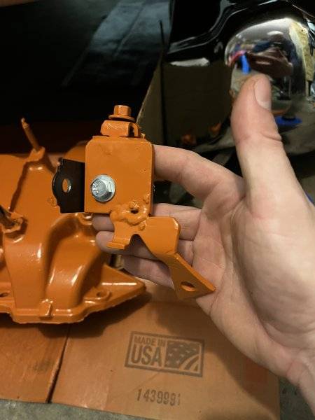

Just a $2 powder coated bracket from the hardware store and some hardware. I’ve got everything apart right now, I’ll snap more pictures once it’s all installed.
