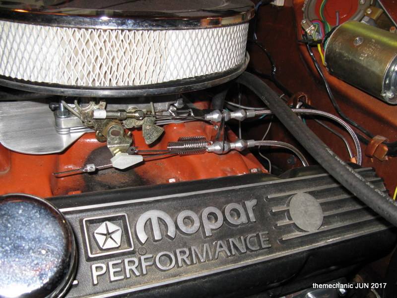

Here's a Edelbrock 1407 with Lokar cables installed before I went to Holley and used the same bracket.
