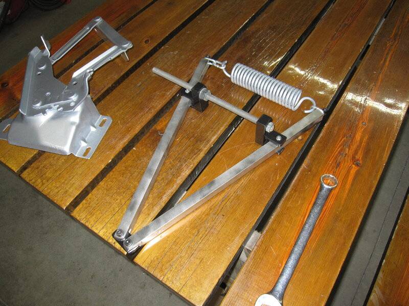

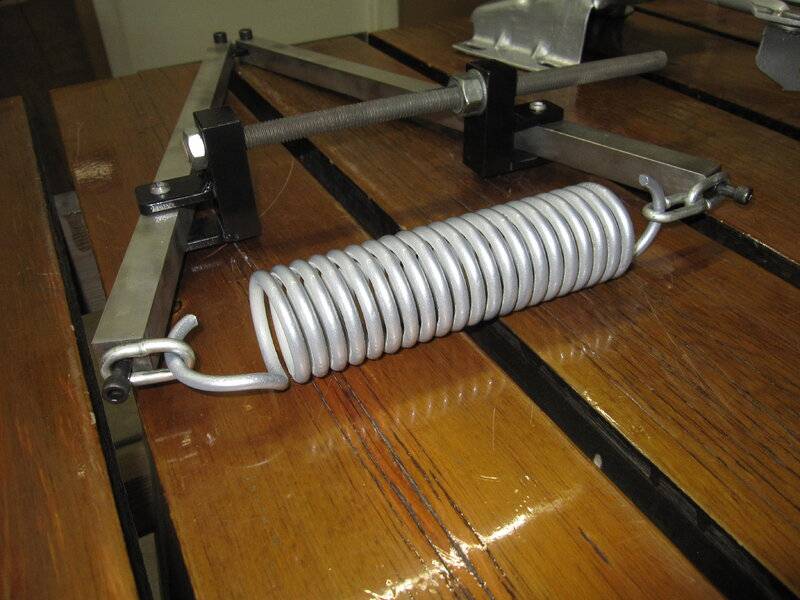

Look at what I whipped up.
493 Mike
12:56 PM
Dec 25, 2011
6,002
7,657
White Cloud, MI
I did not want to scratch/chip any paint putting the hood springs back on the hinges. I didn't!
Mike
I have used an old fan belt to pull the spring back on the hinge.
I used an engine hoist. Worked smooth
A better job will result by stripping everything down. Springs should be spread to achieve good paint coverage.
Mike
I just installed them and opened the hood and masked stuff off to get between the coils. :rolleyes:

Very cool! I fabbed up two jigs out of two lengths of L-angle with holes about an inch apart, with all-thread and nuts to act as spreaders for full coverage when I powder coat springs. One is seriously heavy duty for hood springs and the other much smaller. Yours is seriously fancier and would be great ... except it would soon be covered in a rainbow of powders. Congrats on getting the job done to your satisfaction -- they look great!
Thanks for the kind/snarky remarks! I think I enjoy fabricating tools as much as building the car.
