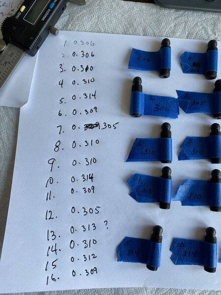

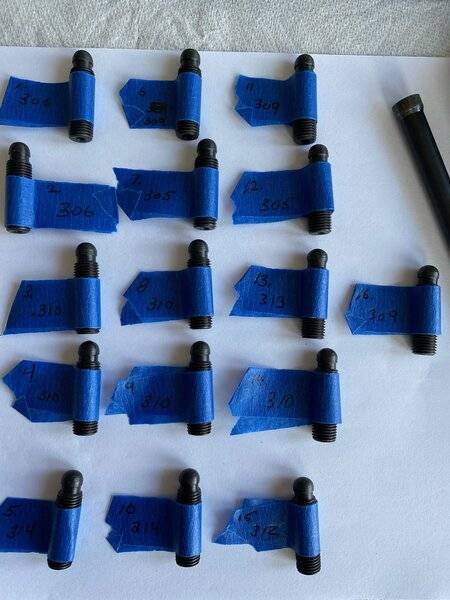

Evening Team FBBO. So, here is the next step. Perform sent 16 new Adjuster Stud Rods. This morning, after a bit of Tea and a Diet Pepsi, I measured the new ones and there are the measurements. So, as you can see, there is some variation. Now disclaimer, I am not a Professional at this, but it does not seem to be Rocket Science. In short, I may be 1 to 2 Thousands off, but you get the point. More in a bit.
If you look at Numbers 13 you can see by naked eye that it is too big. Others have big measurements because, look closely, there are more rings than around Uranus. I am glad we have now 32 from which to choose. Best to the team. Brian
Catch up time. Today it got to 58 here in KC. Tomorrow even warmer. Hurrrrray!. Snow melting. So, the engine builder came over on Sunday. We installed the New Push Rods and found that 9 out of the 16 "adjuster stud rods" were within spec to fit the Push Rods. Fortunately, we needed 8 new ones to replace the old bad ones, so we could put the valve train back together. It fired right up, so we are now ready for TESTING again. Will let you know how this adventure goes guys. Fingers Crossed. Best, B.
