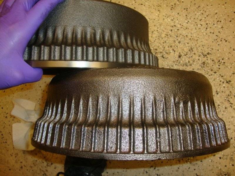

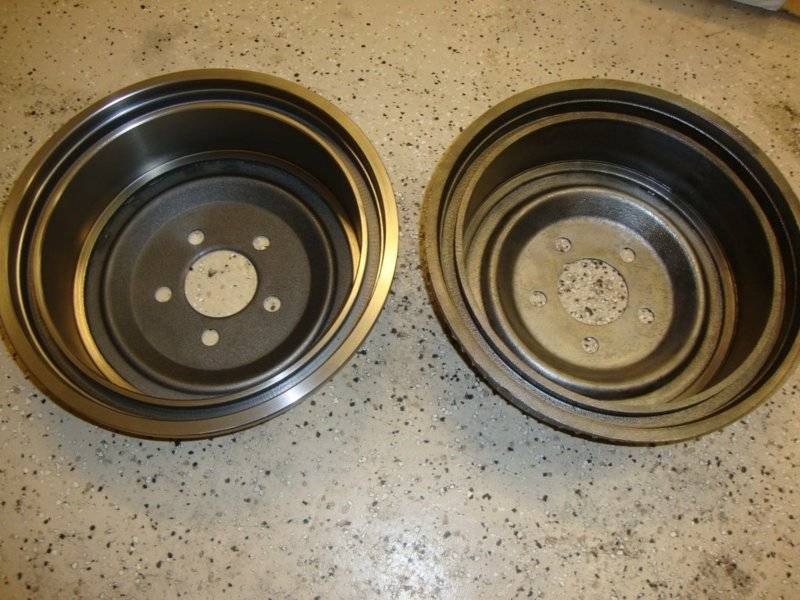

Boeshield T9......NOS Drums that had surface rust and dipped in evaporust..
Looks good. I need to experiment with some other rusty parts and determine what will work best for me. Thanks to all of you for the recommendations.

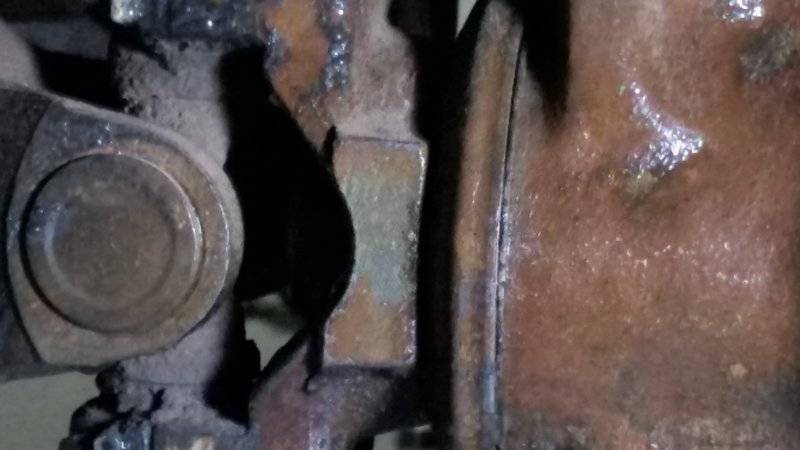

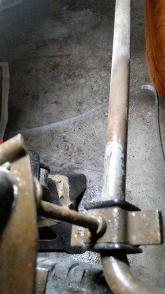

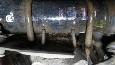

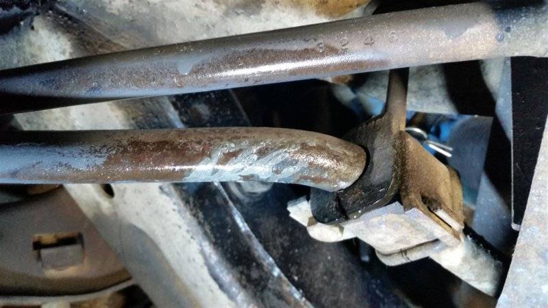

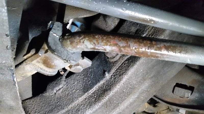

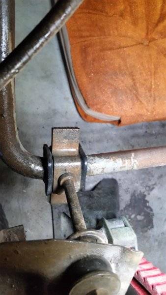

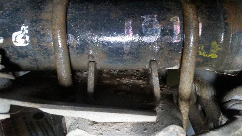

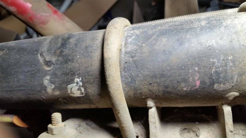

Some more paint marks I found today while cleaning. More clarity on the painted numbers and a yellow dab on axle tube drivers side. Found grey paint marks on rear stabilizer bar on both sides. Checked front and found grey paint runs over black on passenger side and grey paint/red on drivers front drivers side.
Rear Axle Tube Marks 1 Drvr (Medium).jpg Stabilizer rear Left Drvr (Medium).jpg Stabilizer rear Right (Medium).jpg Stabilizer front Right 4 (Medium).jpg Stabilizer front Left Drvr 2 (Medium).jpg

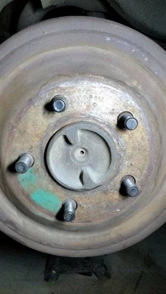

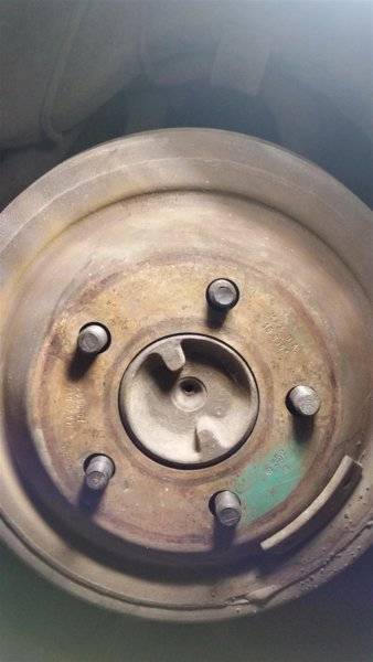

Cleaning up the parts while I'm doing the brakes on my 74 Rallye 360 Charger. I've owned the car for 30 years. I decided to make the car a great cruiser.. it's been off the road 10+ years. No rust at all. As I was cleaning the brake drums and rear axle, I found painted numbers and paint markings. I was going to clean the dirt and grime off the housing and paint it black. Now that I'm finding original markings, they'll be gone if I paint over them. This isn't a restoration, just a clean up and paint. The brake drums must be original as they have the green paint markings and the pentastar and part number on them. Any suggestions as to what I should do?

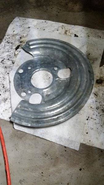

See photos. The front disc brake shields cleaned up like new. Everything is cleaning up great. Thanks.
Terry

I’ve used evaporust. It dissolves the rust, without removing the paint. Plus you can buy it in larger sizes. I bought a 2-gallon bucket of it.
