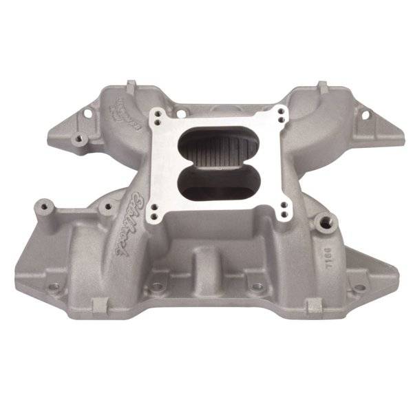

Before getting into any type of machine or porting work, I would change that restrictive intake manifold. You could gain 20-30 HP just by switching to a good dual plane manifold and proper jetting of your carb.

More compression would help. And the recommendation of the rpm performer from @Ironbuilt is a good one too... that stall does seem a little too high. You could try eddy street 5090 heads at 75 cc chamber

Goals: just looking for a little more. Low end more important than top end. It is definitely a street car and will always be as long as I have it. I just got the more power bug after buying a 2016 challenger 5.7. Anyway, I have the intake already. It has been sitting on the shelf in the garage staring at me for the last 3 or 4 years. Since it will need to be milled to fit what I have now, I was thinking about doing the heads at the same time. I was wondering if bringing up a point would make a difference? It sounds like it will. I may go with a smaller converter down the line. I know my cam is not the most aggressive performance grind but it is in it sounds good so it will stay. I will contact the local machine shop too, they have always given me good advise. I am always open to any other suggestions. Thanks in advance.
