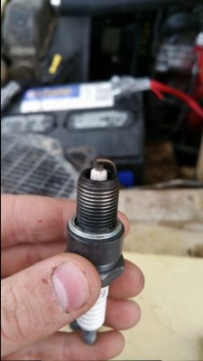

First thing I would do is pull every plug, they will tell you a lot about what's going on...lay them out in order and post it here...
Plug number 1
So I'm guessing those were just installed? They look as if they just came out of the box....if that's the case do you happen to have the old ones?
The old ones are over 20 years old and have been long gone. These plugs are as fresh as the engine.

Your burning oil there. got some peppering on the porceline too. high mileage motor no doubt. So dont raise your expectations to high.
Motor only has 1,200 approximate miles since I rebuilt it. When I first ran the engine, it was running too rich. I put a smaller carburetor on temporarily and replaced the plugs. No more "peppered" look on the plugs.
