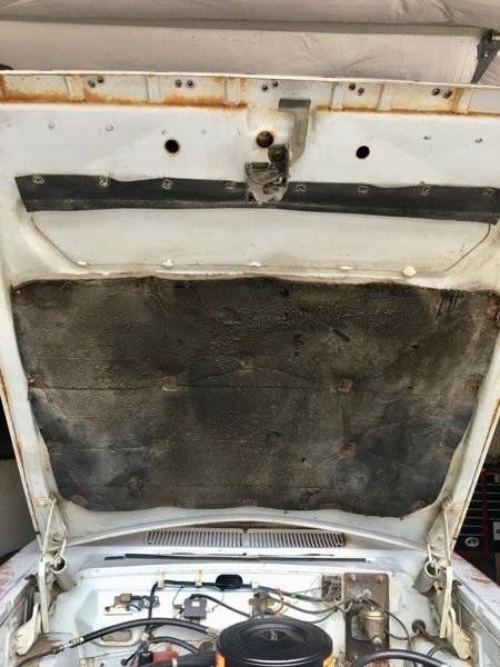

I was sent this from a guy who was looking for a hood seal for his car. said he found it online. LOOKS original cause those steel colored large rectangular head clips are period correct.
Plus it would jive with your picture of the hood seal holes IN the hood being more fwd than the support.

Many people are selling the 63-65 hood too radiator seal that mounts on the rad support as fitting a 62. Even Steele rubber. I don't think anyone is selling the one I show in my picture above that is 62 B only.
I know Joe. I'll call him tomorrow but I'd bet he doesn't have the one in the picture above.

Hmmm. I got mine from Steele, V shaped, mounted to the hood as well. I had to relieve the area for the hood latch so I doubt the one I have is correct.

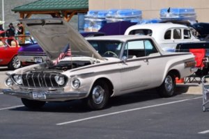

Same picture as above ! this is a guy i know of ,in Utah that has an original wide type on his 1962 polara 500 HT (same as mine A/C car) .It might be another alternative to contact him also rather than wait till I get to mine?
