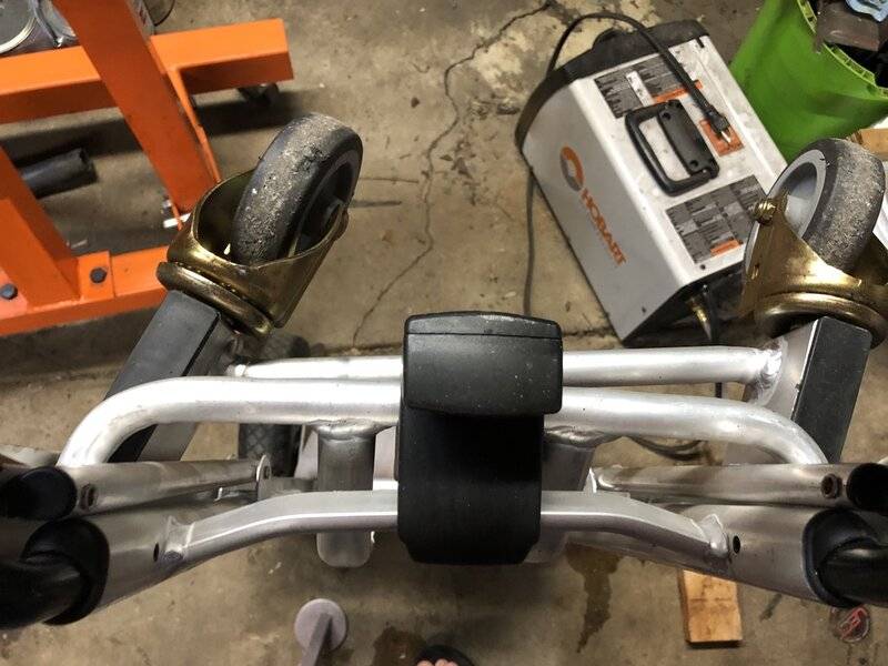

To update my earlier suggestion, I'm not sure I'd recommend the Cosco dolly. Mine had a bit of an accident when trying to get the engine back in the car. I don't think it was user error, as I wasn't moving it when it happened, but the back wheels gave out and left me with a bit of a mess trying to recover the situation.

Nothing damaged too badly I hope.
Geez, hope nobody died in that train wreck, that's bag of suck right there.

luckily nothing was damaged, but it did take me a while to extract the dolly from under the car. To its credit it did fail gradually ;). I put a jack underneath the dolly to lift it up to try and get the engine back into position but wasn’t able to get it close enough to start the bolts.
I ended up removing the front suspension, installing the trans crossmember and putting jack stands under the rear k-member mounts and was able to get the dolly out from under the car. Good final result, but it wore me out, that’s for sure!

Thanks for updating everyone. I had chosen to build a dolly and not jeopardize the Costco unit.
