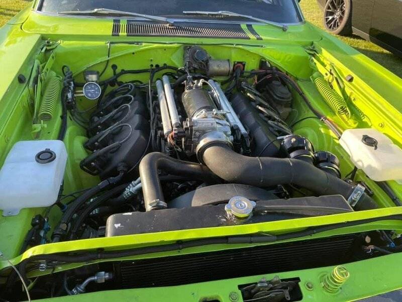

Drive it everyday, everywhere, this was yesterday 50+ miles from home.
Of course, I did the same with carbs.
