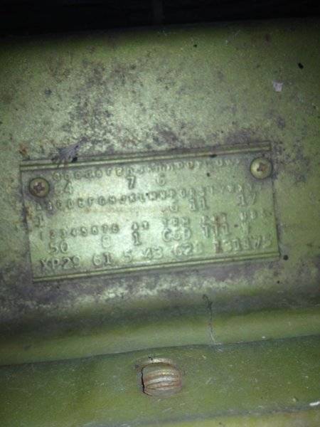

I have no history on my 68 Charger. It was a lot car, but no idea of which dealership, etc. The VIN is XP29G8B438427. I do have the fender tag, but that's it.
Thanks,
Tim
Unfortunately without more documentation, it is hard to tell anything from the fender tag other than the build date, options, etc. Now that isn't saying you can't conclude to some things being a Hamtramck car on what or what would not be on the car. If you post the fender tag, some will probably be able to tell you some odd things that some plants did and at what dates they started or stopped doing certain things on the cars. (ie. early build vs. late build cars)
XP29G8B438427
This vehicle is a 1968 Dodge Charger
2-door Sports Hardtop,
383-2v V8 engine
and was the 338,427th car scheduled for production at the
Hamtramck, MI assembly plant.
Here is a picture of the fender tag. I'm curious if the bumblebee stripe was available on base models as an option or only as an R/T. I'm not looking to do a 100 point restoration as the original engine is long gone, but something believable. Any insights and help is appreciated.
Tim
Bumble bee stripe was only available on the RT models with the ONLY exception being the 68 Bengal Chargers.
Your car did not have the stripe.
Thanks for the info. I was not reading the U B S codes correctly...
Stuff like this can tell you which style shifter may have been in your car if it were a 4 speed, which style vent handles it had in it, what dash emblem, etc.......early built cars had differences when compared to later models.
Oh ok well its a late build then.
