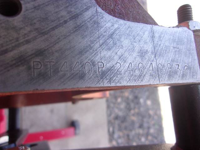

If your looking at the bottom of the engine you might as well look at the ear below the starter... there will be numbers stamped there... Like this...
The PT440 just tells you its a 440, the next code, in this case a P means premium fuel but thats just a regular 440... A HP 440 would have an S in that location....
What did the S stand for? And the series of numbers?
1 Wild R/T
12:30 AM
Jul 9, 2019
7,817
20,171
California
PT = Trenton Engine Plant
440 = No Idea??? LOL
P = Premium S = Special
2464 = April 26th (10,000 day calendar)
0839 = 839th engine assembled that day

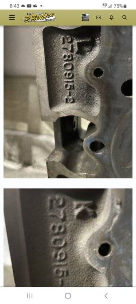

I should know this, and probably did, but what is a SPD?
My VIN: WS23L8E149014
My SO: E8W221190
Below is a photo of part of the numbers on the passenger side of the block. I took it using one of those inspection cameras. I couldn't control the snake well enough to get a better shot but maybe those of you with sharp eyes and a knowldege of what would be there can glean something from it.

SPD is scheduled production date. Its on the fender tag.
